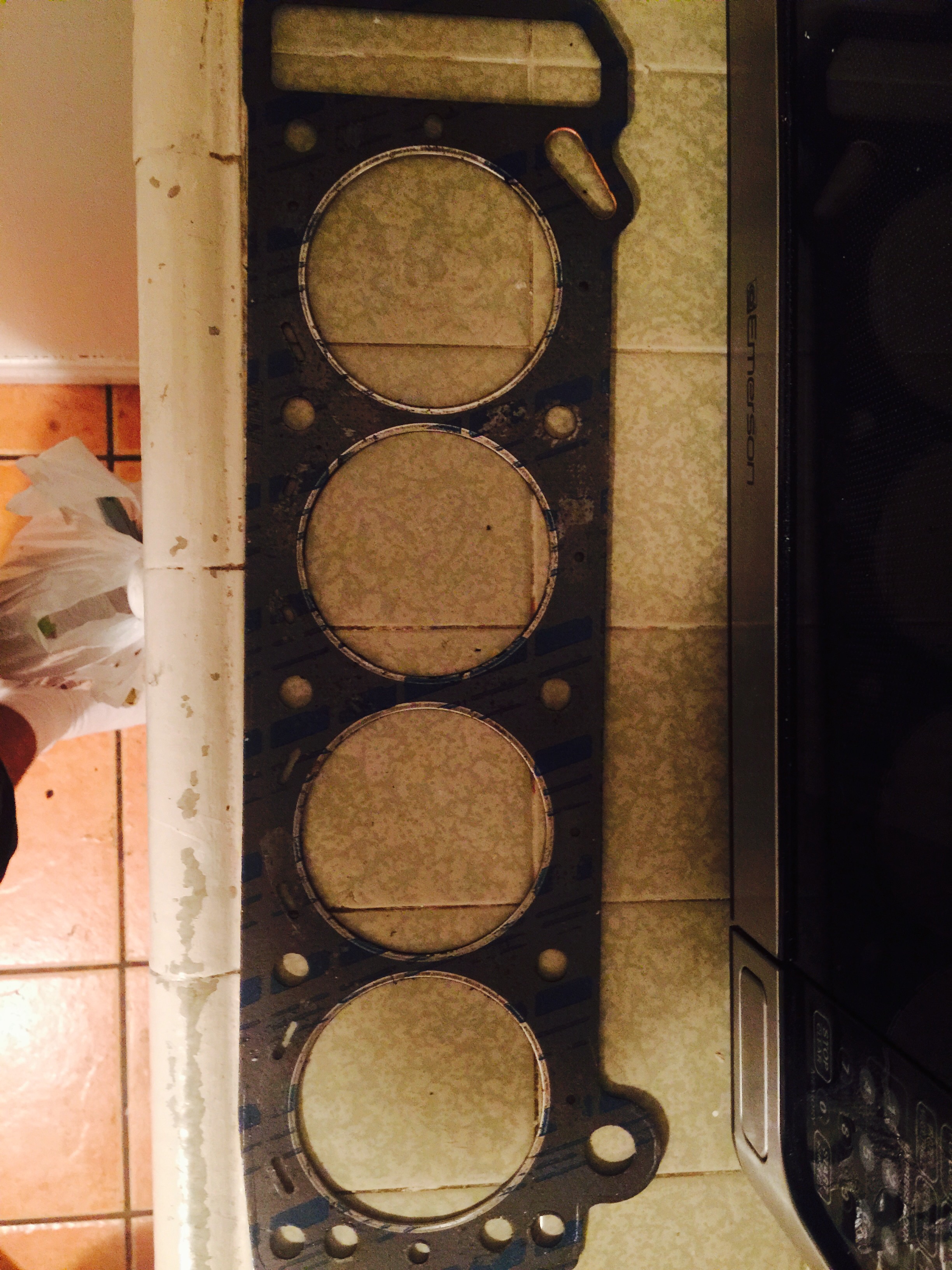

I just took off the brand new cylinder head and the new head gasket
What did I possibly do wrong the gasket and cylinder head are in phenomenal shape ???
I torqued the head bolts to 58

Can I re use this head gasket

So I installled it.. Tried to crank the engine it wouldn't turn over after the 4th time it turned of it idled really high and then died when it died I heard a loud pop inside the engine ???? Am clue less right now

Old Jan 21, 2015 | 03:20 AM
92ehatch's Avatar
Joined: Jan 2015
Posts: 652
From: Hendersonville NC
Did you reinstall that used gasket? That is a no no.
Check the head and block for warpage with a straight edge, if they are ok put a new gasket on and try.
Those are basic mechanical do/don't.
