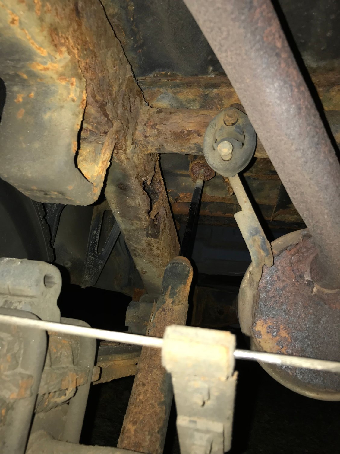

So I started hearing this noise today when I go over bumps and when I got home I looked under the truck and saw the rear left shock mount for the frame ripped off. The shock is extended and rubbing on the underside of the bed. I’m not really sure what to do and this post is more of me venting rather than looking for answers I think. It’s a great truck of course, runs perfect, gets the gas mileage that it’s supposed to and looks great doin’ it. Just the frame is getting worse and worse.
My my plan is to unbolt that shock for now (or should I weld it to a plate and back on the frame?) and I’m thinking of getting a new truck. Not NEW, just new to me and then sell this one. Not sure how much I can get for it. What do you guys think? Truck has about 130k miles and other than the rust issue it’s a solid truck. Body is in great shape save for some certain parts that are rusted. Attached a picture of the truck too.

if the rust in like that in one spot it is like that in more place. Plating the frame you would need to pull the bed etc.
i would say it is now a parts truck

You COULD look at junkyards (local or southwards) for a donor frame in good condition, but I'm not familiar with frame swap costs and/or complications. However, here in the forums are some folks who have tackled it.

Yeah, checking out the rest of the frame it’s not great. The outsides, tops and bottoms of the frame rails are solid but the inboard sides are cancer ridden. I was expecting more rust actually. I’m considering welding it up. My mom works at a landscape supply place and they sell steel edging for gardens. Comes in 10’ lengths of 3/16” x 4” wide flat bars for $40. I can weld and I’m just stupid enough to think it’s a good idea.

I know! Such a shame. I think the PO drove in acid right up to the frame because the rest of the truck doesn’t match the frame’s condition.
I have ave been reading and watching videos of people swapping frames. That’s just a pipe dream for me. Don’t have the resources or money to pay someone. Just for fun I asked the dealer what it would cost...something around $15k. I laughed and then I cried.

I'm betting if they tanked that frame you'd just get back a hand full of captive nuts and a couple pounds of misc steel bits.
Normally I would say get a rust converter and sealer on it ASAP and keep it clean. From the photo I would say you have maybe 1/3rd of a decent frame there.
That's a pretty typical failure spot, usually either the top or bottom of the dogleg will rot out once you lose the frame dust caps they rot from the inside out when not protected.
Been driving the truck with one rear shock and I can’t really notice a difference, haha. I wasn’t really able to assess the truck as well as I wanted to this weekend so I’ll drive it up on ramps and go at it with a hammer this coming weekend. Then, if it’s a go, remove the bed and have at it the following weekend.
Yeah, if this bed was dipped in the pickling acid it would just be consumed. If I were to do a frame swap I would get a good one from down south and have that one hot dip galvanized/powder coated. Not going to happen though.
This is a strong indicator of the shock had failed before its mount broke.

Hey guys, so I checked the truck out yesterday much more thoroughly and sad to say that I’m not going to fix it . Too much rust and too much rot for me to deal with.
