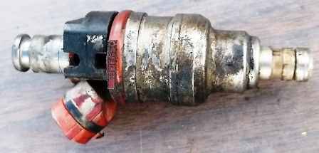

Have I busted the injector, or is the part useless?
Finally got to tear down the intake side of the 22RE, pulled the injectors, never actually seen one before, saw the parts to replace according to Haynes and FSM, but not mentioned anywhere is a "nipple"(some kind of plastic thing on an original) at the manifold end which all disintegrated when the injectors were extracted. Haven't checked dealer yet but NAPA has a 3 piece kit (2 grommets and an o ring), they used to have a 4 piece including said nipple, but it has been obsoleted.
Does that mean we have decided we can live without it?
All 4 are in their own script bottles full of seafoam until reassembly.
Picture shows missing the nipple
Thanks
Attached Thumbnails Have I busted the injector, or is the part useless?-injector.jpg

I think you are talking about the cover that goes over the very end of the injecotr? I have had them to come off and be so deterioated that I just left them off and no issues.
Here is the seal kit I get, you get screens also for the same price as you are going to pay at a parts store for the seals.

Commonly called a "pintle cap." There is no Toyota part no. for them, but they are commonly offered: http://www.ebay.com/itm/331112021116?_trksid=p2055119.m1438.l2649&ssPageName=STRK%3AMEBIDX%3AIT
23,000 miles ago I didn't know that, so I just reinstalled those injectors with broken caps. It doesn't seem to have made much difference, but once again I have the opportunity so I am replacing them now.

Sorry $18.99 each isn't the same as NAPA

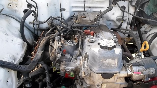

Like I said, never actually seen one before, but seen lots of pics, the tip is always just the metal injector. Looks like a boot with a round hole in it surrounding the outputs. I'm going with $1.50 each and live without the "boot", I already have a filter the size of a ben and jerry's container.
Something you can't figure out it's function anyway will be bypassed in this case. Definitely wasn't putting the broken ones back in... by lack of availability it appears it was an engineering overkill at design, an American trait. TB, Plenum and manifold going for ultrasonic for $30. I thought the TB looked bad in front of the butterfly, found like 1/8 inch of San Diego sand and carbon buildup behind it into the plenum, what a mess!! I'm guessing at this point but it appears the whole EFI etc. harness all terminates at the ECM? I'm going to pull it, clean it and replace all the tape and spiral wrap, seems a good idea and a simple job

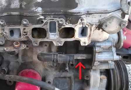

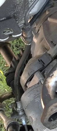

Maybe the six comes with the pintle thingy, this is the 4
3 pictures for 3 subjects
Got the intake off took 3 times long as expected, why did I buy that Haynes manual, oh ya the price.. So Haynes says intake connected by 8, 6 bolts and 2 nuts. I was already up to 9 when I still couldn't get the intake to let go. Completely undocumented hex cap screw about 4 inches long just in front of the thermostat mount, that's why the FSM is so good (don't know if it's in there either yet) I want to replace it with something standard but don't know for sure that it's there because of a clearance issue or something, are these changes common in mid production run??
I found during disassemble that the flexible clutch line is about 3 inches too short caused by the 3 inch BL so no attachment at either end.. Anyone know what vehicle I might ask for for a longer substitute? Or maybe I'm just going to have to trial and error search for it.
Somebody was asking about a coolant line and where it belonged, I found it after pulling the intake, goes from pump to heater core line, with a side route to the throttle body if still wondering..
