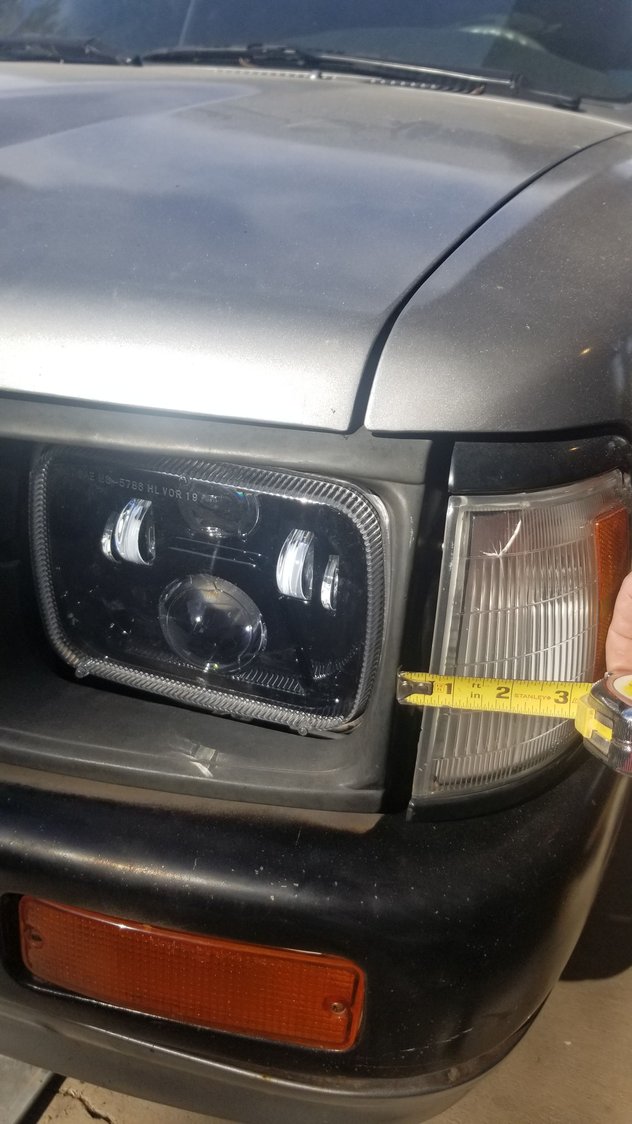

I just installed LED headlights along with the relay harness and I'm concerned about water getting into the connector. Should I put dialectic grease in the gaps to protect it? Maybe I'm just being too cautious...not too sure about electrical stuff.
Another issue: There are gaps between the grill and corner lights. I'm missing 3 out of 4 of the little plastic inserts. Think that's the issue with the gap? Anyone know where to get these plastic inserts online?

I, personally, use dielectric grease in every connector I assemble. IOW: I pull a plug wire, it gets a shot of grease before I put it back on.
I, myself, would give a little squirt of the stuff into both the front and back side of those headlight plugs. I do it to all plugs I work on. It reduces corrosion build-up, keeps the crud out, and makes it easier to slip them on/off.
Most of the factory plugs seem to have a seal of some sort on the back side. A rubber boot, a rubber insert, something like that. As long as that factory seal is still good, ie: still soft and have a good seal to the plug body, I leave them alone, and just give a squirt of grease into the front side of the plug. You don't need to do both halves of a plug assembly. Just a dab into the female side does the trick nicely.
All this just the way *I* , personally, do it. Maybe I over use the dielectric grease, but it's worked for me over the years. Very nicely, it's worked for me, so I'll stick to my policy of the way I use the grease.
Good luck!
Pat☺

If you could not find the plastic inserts, Try big zip-ties where they go. I think they're just there to center the bulb and make it slide better for adjustment.
While I got may airbox, rad overflow tank, etc out for power steering gear box replacement, I WILL re-apply dielectric / bulb grease on connector pins, and seal the back side with drop of RTV silicone.

The beam patterns look good on those. Good choice. BTW, I sealed the back of my Truck-Lites connector with RTV Silicone. Pins got fresh coat of silicone grease and I taped around the interface.

That's what I'll do. ..RTV or silicone to protect the plug from water.
Still trying to figure out why I have a large gap between the grill and corner lights. Something seems off.
BTW, it was like this before I installed new headlights.

The corner gaps are pretty common. Mine has been like that for 15 years. LOL
I think it's because the fasteners wear out over time and they pop out while driving. There's a good bit of tension pulling the corner pieces outward that can overcome the fasteners.
