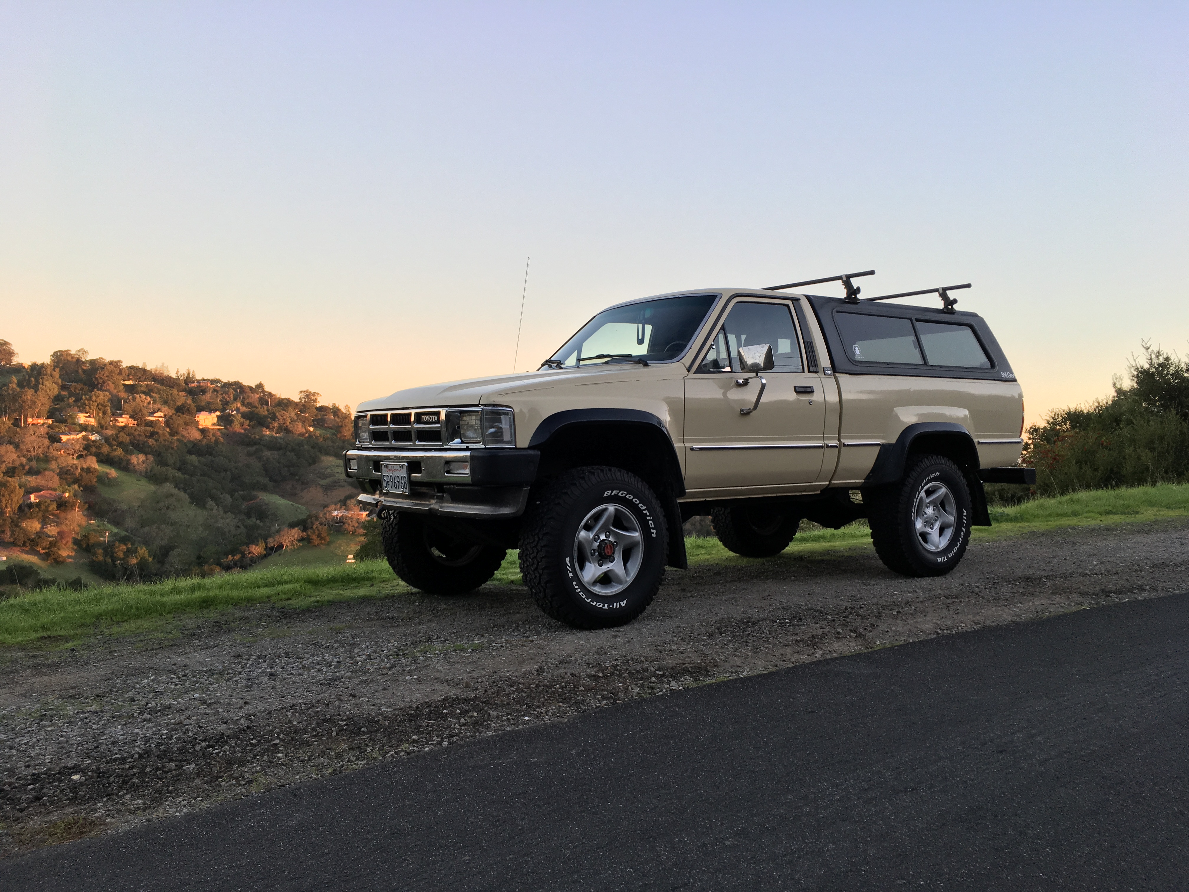

Howdy all,
The good news is that I picked up my first yoda, an 86 22ret! And it's badass. Ive had it for about two weeks and smooth sailing up until yesterday. The bad news.
