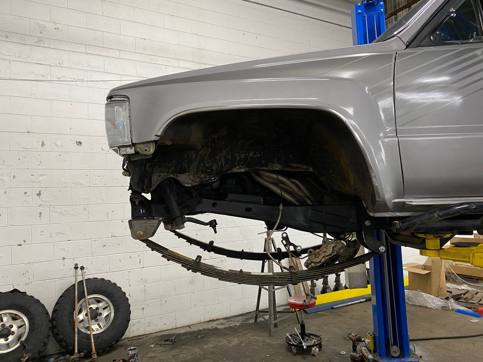

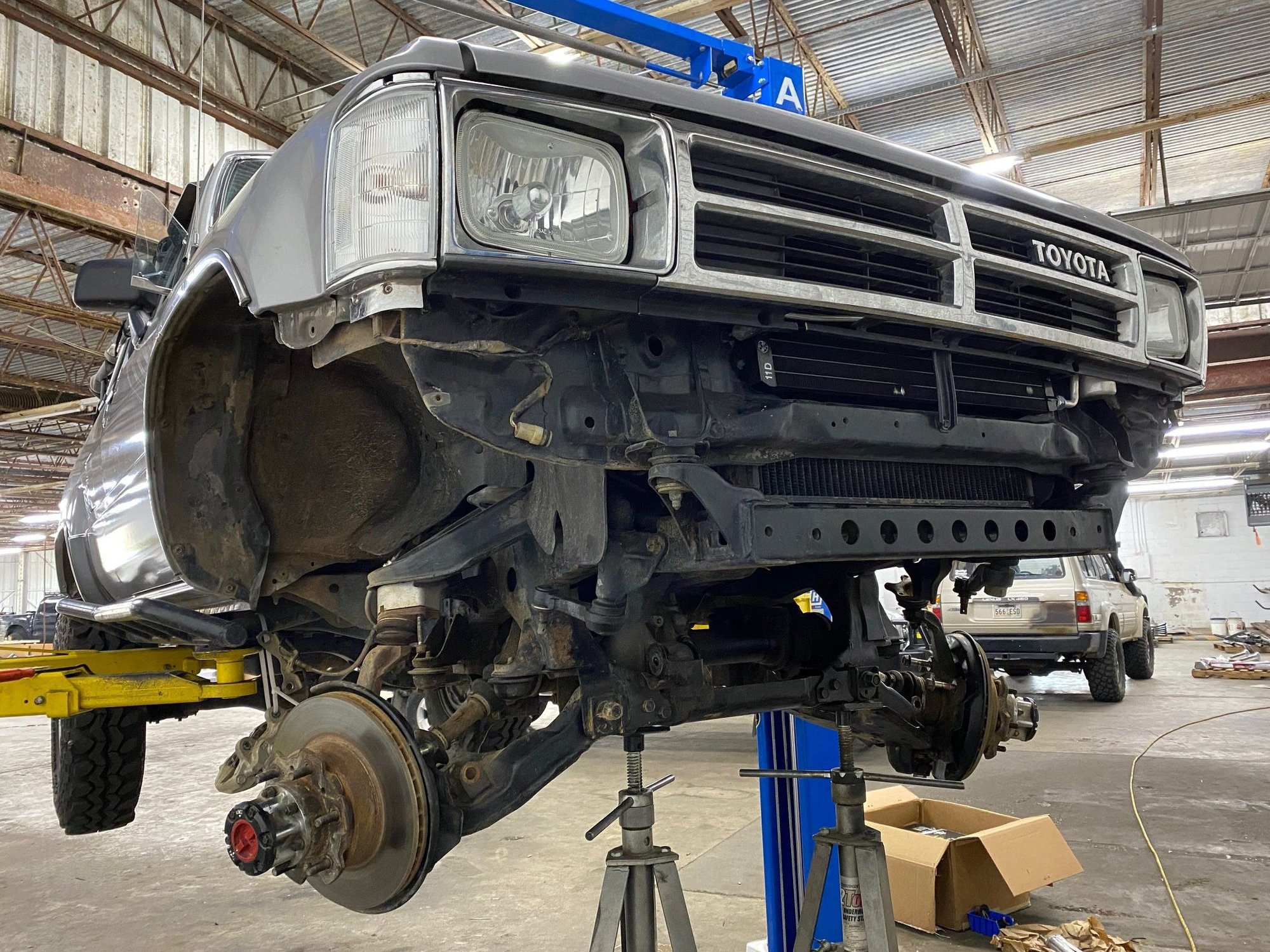

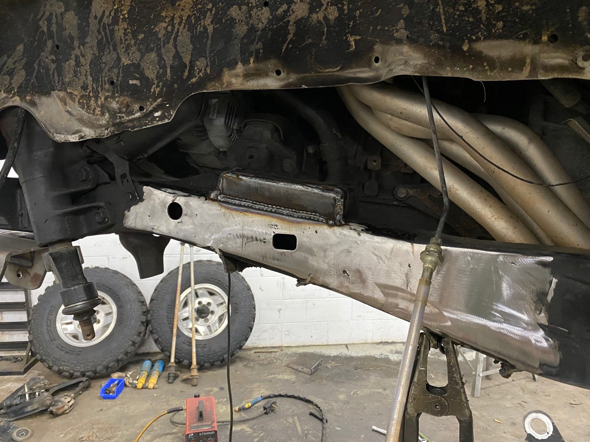

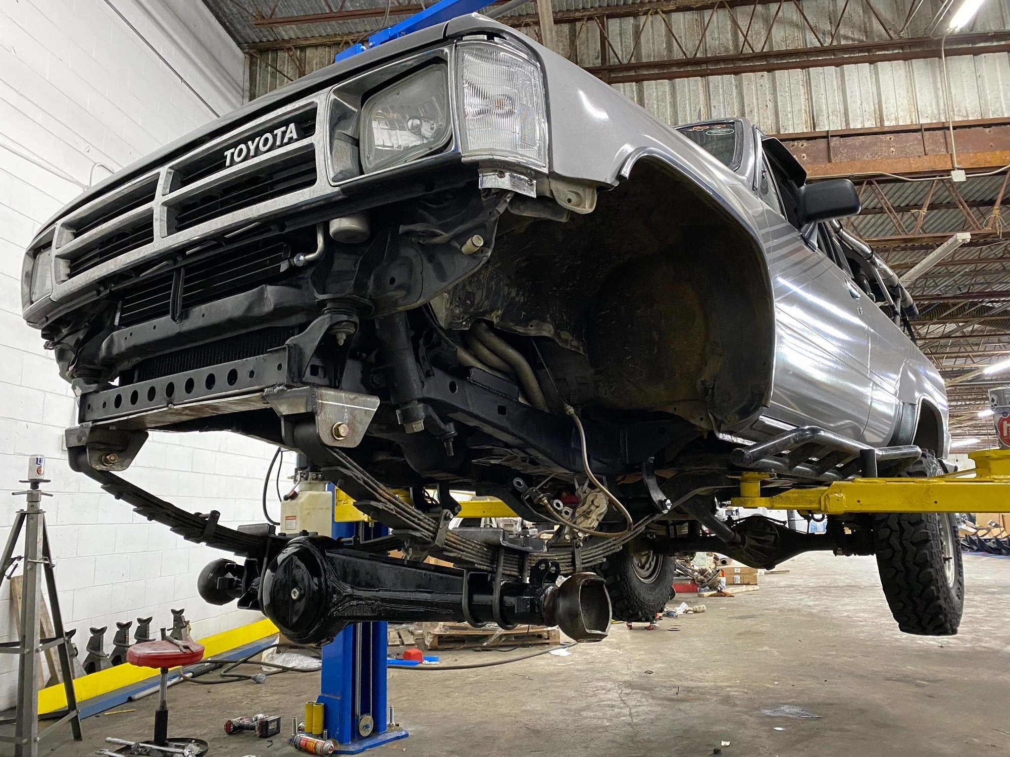

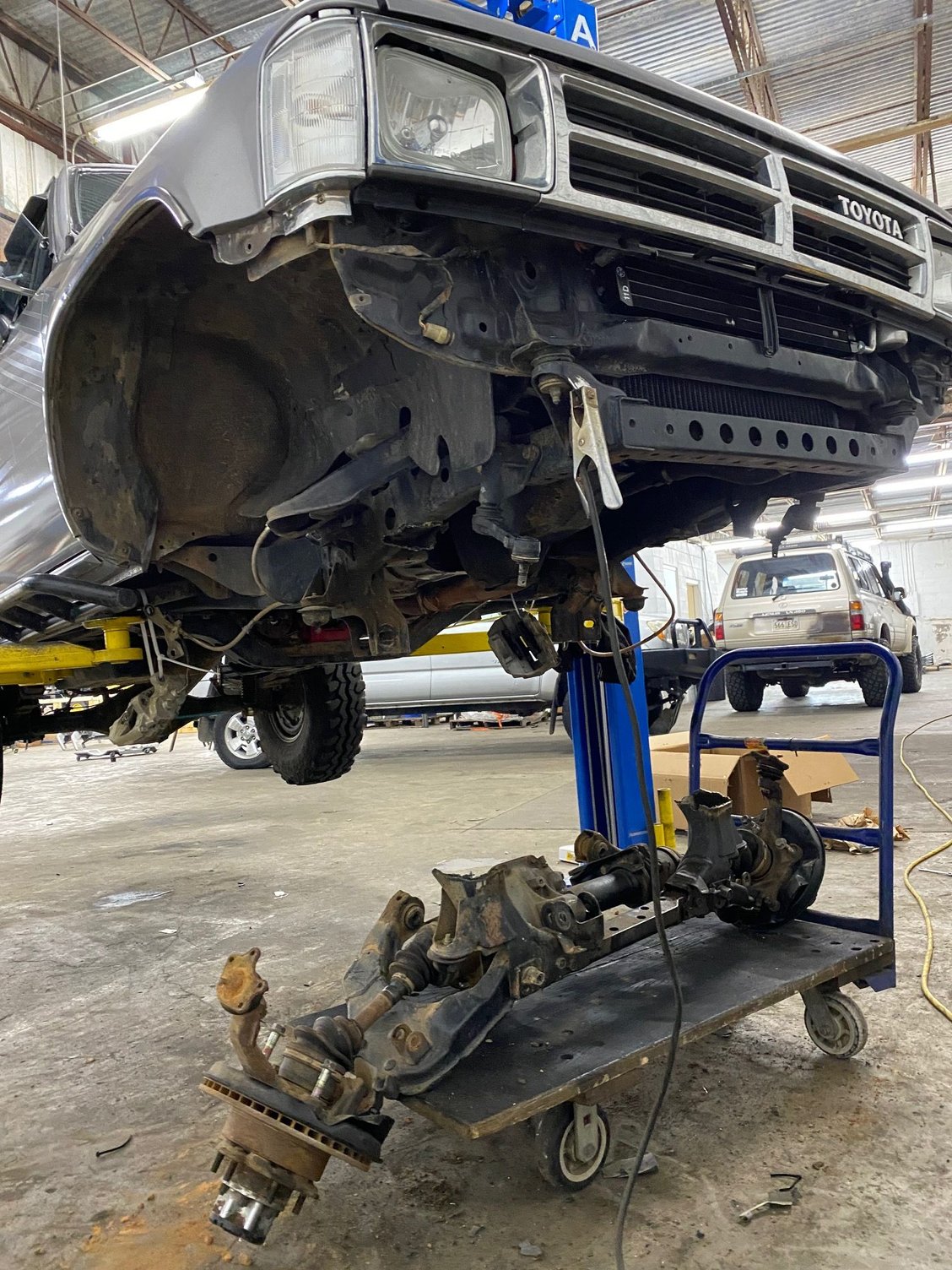

started the sas. first impressions are that it will be significantly lower than common kits such as trailgear or allpro, exactly what i wanted. parts are quality from Sky. the spring packs are USA made which is nice. hardest part was burning the front shackle tubes in, if i had to pick. i fully expect to clock and move the steering box forward but i dont know how much yet. will see once i get the steering arms on. just eye balling, id say the front sits about 2 inches higher than the rear which has OME packs, so about 2.5-3 inches of lift. ill do some exact measurements once have tires on the ground.
