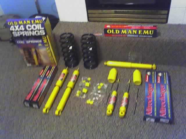

Hey, Lookie at what I got today!! X-mas is now a summer thing in my books This is the Kit from TRDSParts4u.com down in Dallas. Phil (Strap22) on here, helped me out with the transaction. Very nice guy to deal with and I would definatly buy form there in the future. Ok, now with that said,....\
WOOOOOO HOOOOOOO!!!!!!!! Look what u guys made me do!!! Thank you so much!! To all you...
I'll get some more pics tommorow of hight differences and the like.
Cheers, Lee

Sorry bout the mix up, here's the lift.
Attached Thumbnails Getting ready for lift!! Final questions.-20-05-06_0111.jpg

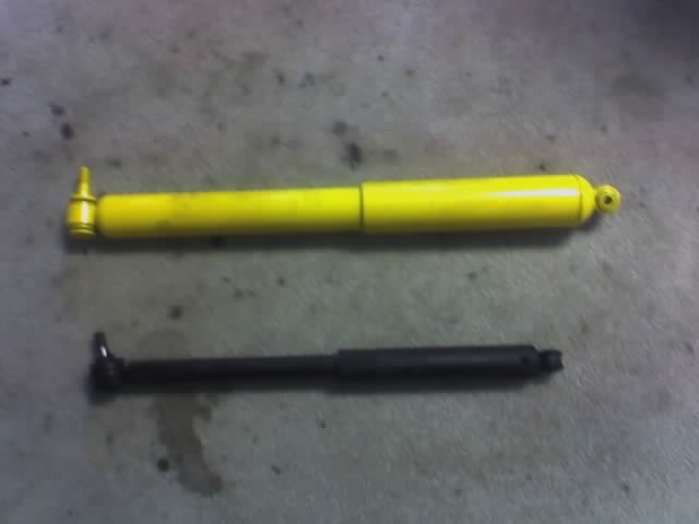

Here's what we got:
1- SD33 Steering stabilizer
2 - N98 rear Nitrocharger Shocks
2 - N72F Front Shocks
2 - 901 H.D. Rear Coils (No more sag-ass )
All misc. bushings and bolts. Just waiting now for the 2 - SDORI Ball Joint Spacers Getting that thru the snail mail. But ya know what kinda sucks...all I got was one lousy sticker and it just has "OME steering stabilizer'' on it. Ah, well. We'll see if I can get anymore.
Cheers, Lee

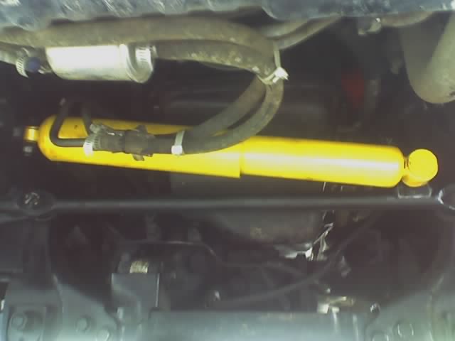

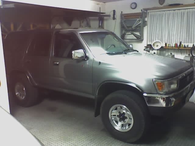

Something a little different about the truck today..... I can't quite put my finger on it. Woo!! Holy Sweet Mother of Stance!! Yeah sa you can probably tell, so far I've only done the rear (as well as the steer. stblz).
Getting the B.J. Spacers soon I hope so I can git'er done. More pics to follow plus some measurements tommorow. Hope ya like it!
Cheers, Lee
Attached Thumbnails Getting ready for lift!! Final questions.-21-05-06_0239.jpg   Getting ready for lift!! Final questions.-20-05-06_1457.jpg   Getting ready for lift!! Final questions.-20-05-06_1436.jpg
