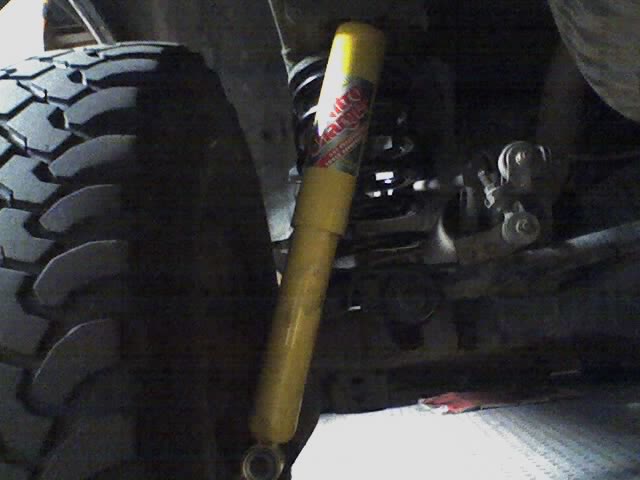

A couple more....

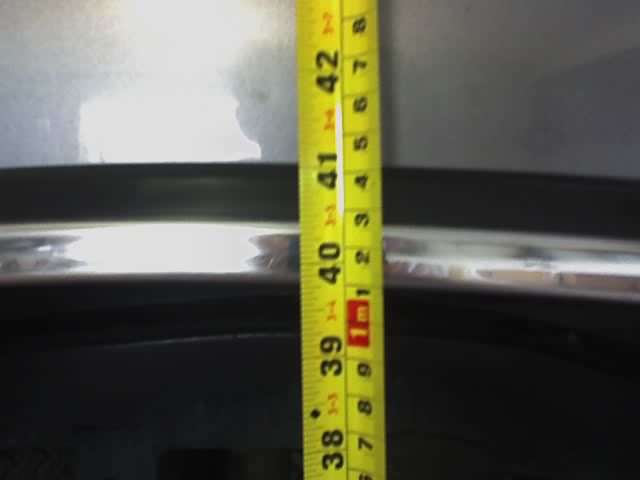

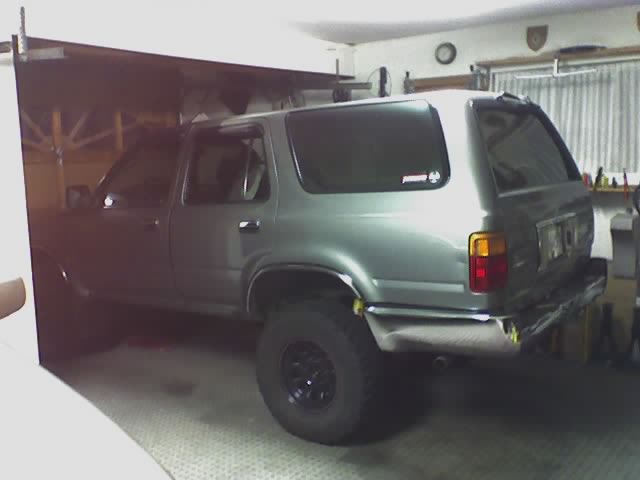

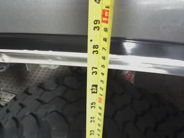

The last one that say's 40" is the stock susp. at full droop with the truck on jack stands at the frame at the wheels on the ground.
The second one is what the truck sits at now on the ground! 37" and a just c-hair more.
Sweet!
Cheers, Lee
Attached Thumbnails Getting ready for lift!! Final questions.-20-05-06_1711.jpg   Getting ready for lift!! Final questions.-21-05-06_0241.jpg   Getting ready for lift!! Final questions.-21-05-06_0238.jpg

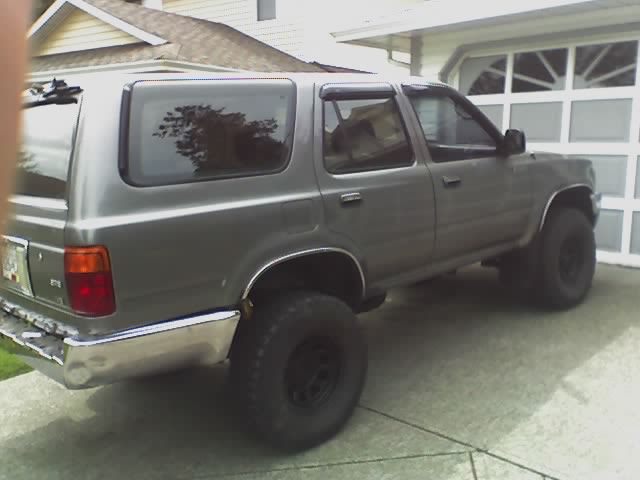

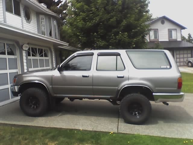

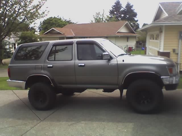

A couple of quick one's!
Attached Thumbnails Getting ready for lift!! Final questions.-21-05-06_1420.jpg   Getting ready for lift!! Final questions.-21-05-06_1419.jpg   Getting ready for lift!! Final questions.-21-05-06_1418.jpg

Talking Mearsurements
So here's what we got...
Sit's at 37.25'' Drivers Side
37.15 Pass. Side
OME 901 H.D. Coils and N98 Nitrochargers.
Stock Coils and Shocks:
Just BELOW 33'' from ground to top of wheel well (
Because of the pan hard bar being off-kilter now, the axle now sits just about an inch over the driverside wheel well and visaversa on the Pass. side. I'm not too worried about the set-up right now. I just got back from a little wheelin to stretch her out a bit. Alls was Cool.... And about takeing the panhard off for coil installation? Well I decided not to. I just compressed the coils a lil bit with some
high-tensil rope and popped em in. After that, not even 45 mins. and I was done! I tell ya, WAY easier than I thought it would be.
Let me know what you guys think so far!!
Cheers, Lee Hathaway

Holy Crap!!! I just went for a little wheelin and I found a 2.5' Riser for a jump.... And wow.... The back end touched down soooo smoothly. The front, well, not so much. But, I tell ya, These H.D. coils with the new shocks, They are a godsend. Damn, I wanna finish the front right now!!!!
Jeez I cant wait
Attached Thumbnails Getting ready for lift!! Final questions.-21-05-06_0244.jpg
