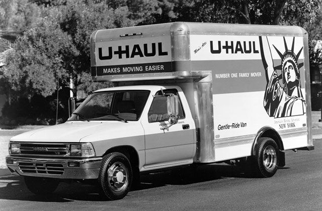

I had to google toyota uhaul, what a cool truck.

Ive seen late 80's to 90's model 2wd duallys before, with a small box on the back and I think that is what these were ordered for but they didnt work out for that application. I worked at a uhaul rental center back in the early 90's.

Thanks for that pic JC! That brought back some dead brain cells!
