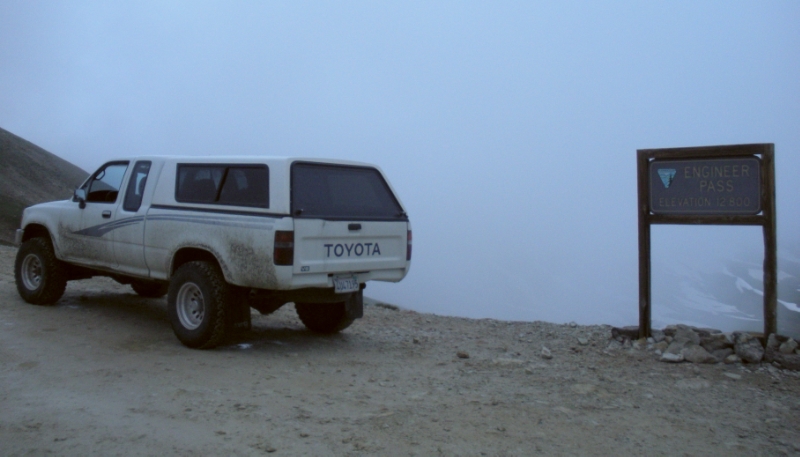

Looks like we've been up some of the same roads Derockus ...
My truck was only functional in 4 lo up at 12k feet ... No power whatsoever with normal gearing ...
I've owned both the 22re and 3vze , I prefer 22re for many of the reasons listed by others above . Easy to work on , way simpler engine , (research 'valve clearance check' on a 3vze and see how complex it is compared to a 22re) and of course legendary reliability on 22re .
Power is not too much different , I bet if you ran lower gears on your 22re you'd have acceleration similar to a stock 3vze....
Cool trip ain't it! Yeah, definitely in 4Lo the entire time. Both for more power on the steeps and just better speed control negotiating obstacles.
