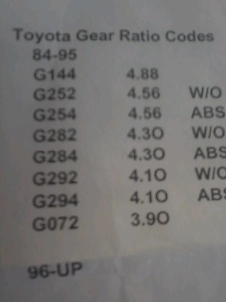

Brian, no doubt the cheapest option will be to find a factory 4.88 7.5in diff. Certain year 4runners I think with automatic transmissions came with them.

later model 4x4 auto trans with 31" tires AND tow package only unless specifically optioned. I believe youre looking for axle code F144 for a 4.88 dif.
