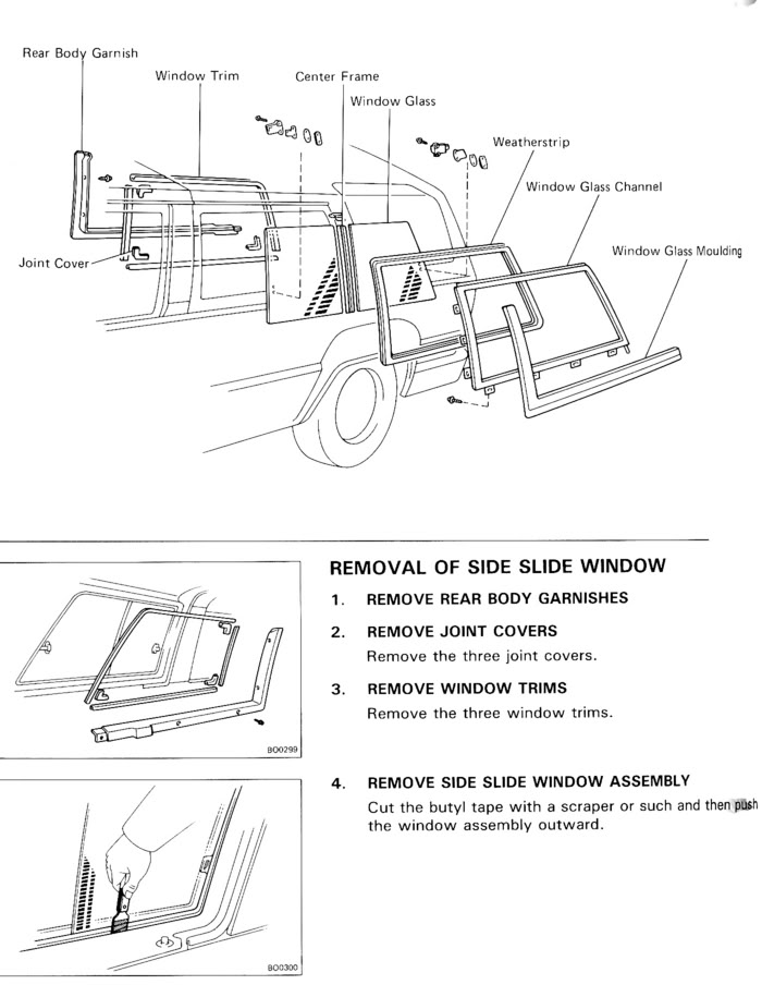

You have to remove the complete glass assembly and once it is off, you will have access to the screws.
L Trim Removal.
To get the L trims off, you have to remove the whole window from the inside. On Passneger Side, I have my feet in the floorboard and knees in the seat, I place my left arm across the top and apply pressure from my elbow to my fist. Applying a little more with my elbow and start breaking the glue tht holds the window in. I try to keep all of the glue on the glass portion. I use a putty knife to help. Once I get the top seperated from the cap. I hook my arm thru the window to keep it from falling to the ground. Once the glass is out, the L trims are just bolted to the window part which will be visble when out.

Terry thanks for the pictorial instruction! next hot day on the weekend putty knife in hand ill hack at it! i was on ebay looking for a shifter bushing rebuild kit and going through the listings the L trim was there. i had to jump on it. I'm surprised what i can still find for my faithful blue 4 runner. just rebuilt the engine too. she's a 220k and she's ready for another 200k
