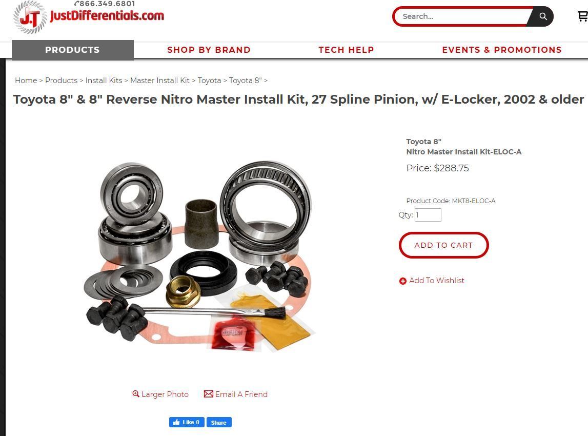

Bearings?
I'm also wondering if I need to buy a bearing kit for the elocker diff too or will my bearings work out of my stock diff?

The elocker will need an elocker bearing kit if you are looking to rebuild it. You can use the 410 ring and pinion in the elocker since the 410 is a long pinion head from the 86 models.
