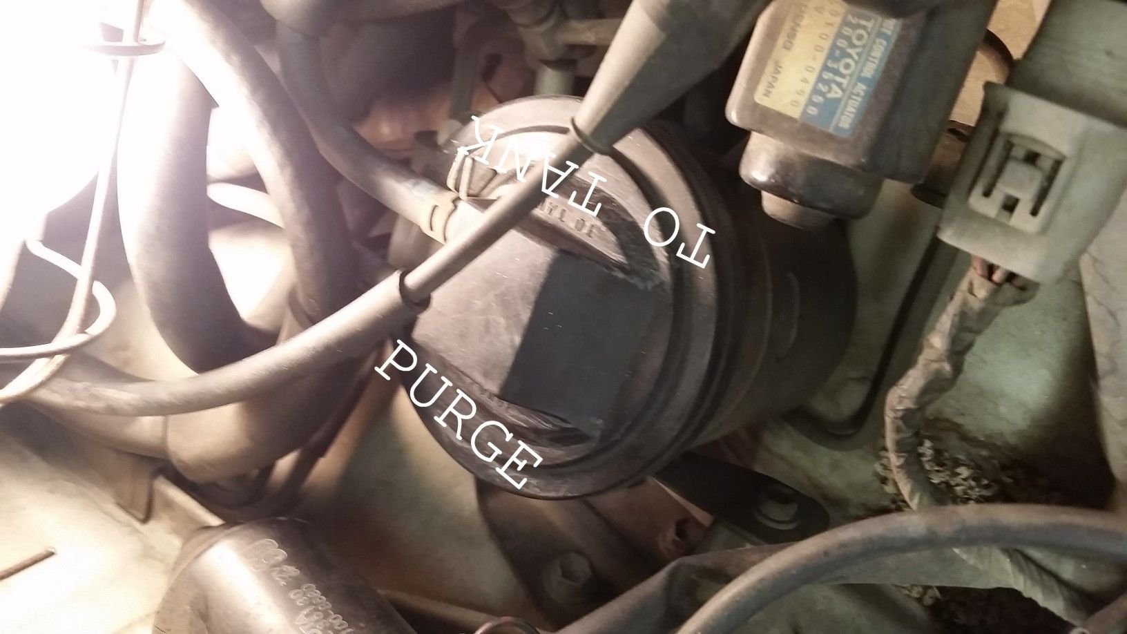

My 1994 V6 2wd 3VZE - when I start it after several hours, it takes around 3 seconds of cranking. I can immediately turn it off and restart instantly. After driving a bit when I park it I can smell gas but can't see any on the floor. Here's a pic of the area that seems to smell the strongest. I have no idea what the can shaped device is but it has two hoses and it is marked "PURGE" on one side and "TO TANK" on the other. Could this be the source ? What is it ? Seems odd that it smells strongly but no gas is anywhere to be found.

The can shaped device is your evaporative canister. http://web.archive.org/web/201109110...17evaporat.pdf It adsorbs fuel vapors from the tank into activated charcoal, which is then later sucked into the engine through the (wait for it ... ) purge line.
You have two (likely) possibilities. The most likely is your purge line is not pulling vacuum (disconnected? clogged?). On the 3vze the line has the TVV between the canister and the throttle body, but it looks like you have a 22re. If the fumes aren't getting sucked out by the engine, they'll "ooze" out of the canister and you'll smell the fumes.
The second possibility is a bad Fuel Pressure Damper, but I believe that's only a 3VZE thing.

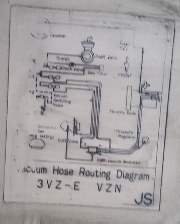

I'm sure it's a 3VZ-E - Underneath the hood pics - Right now I cant do much, eye problems but thanks for the info
