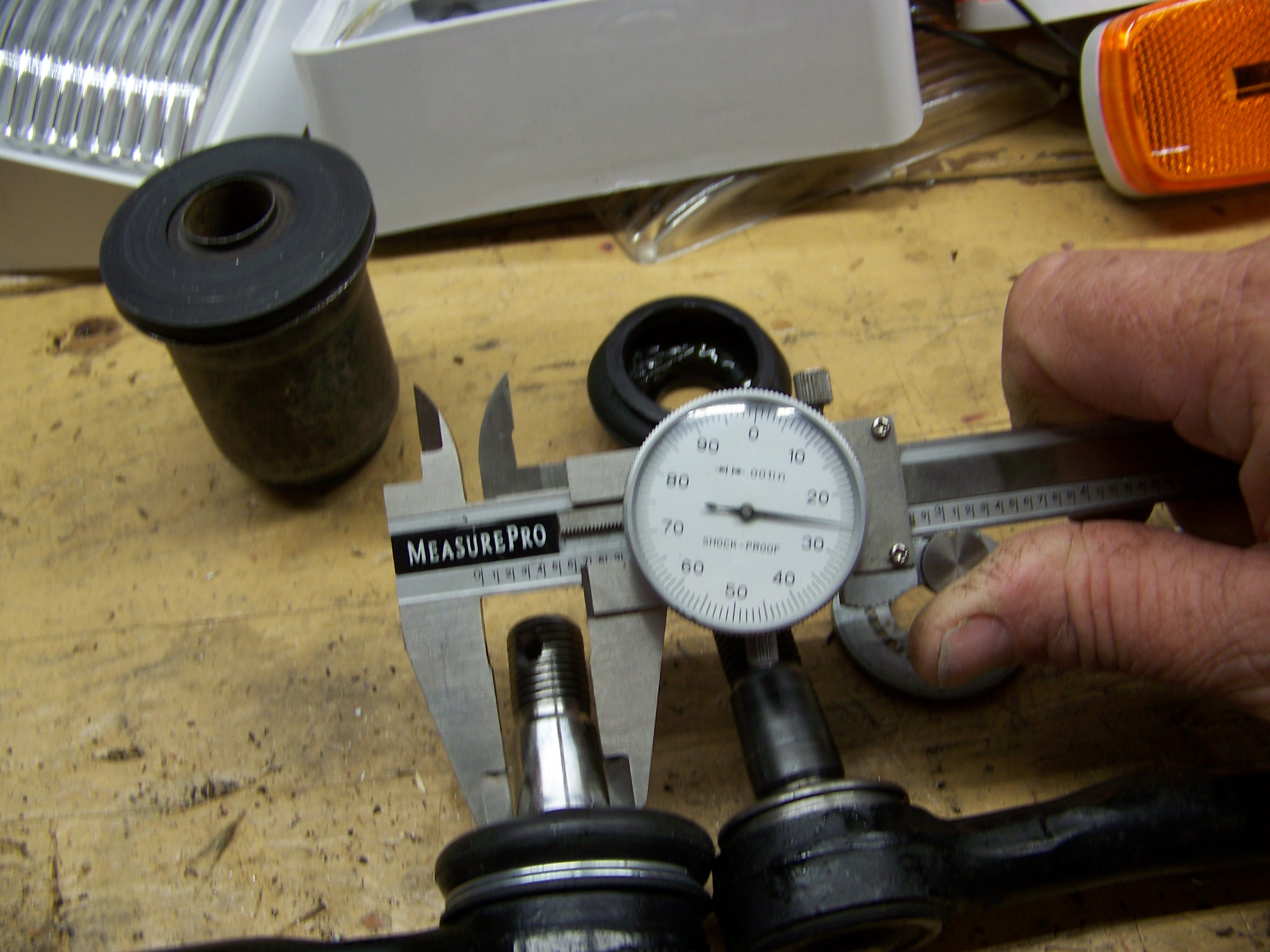

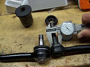

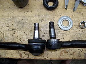

Update to thread
After sending Detroit Axle an email asking about the problems with the parts in my kit and not getting a reply, I called them. They asked for the part numbers and were willing to exchange the parts after verifying they were for my truck. The shipping was $25. I decided not to do this as I bought the needed parts locally. A further check on the defective parts has revealed the conical taper is shorter than the original part and narrower at it widest point than the original part. This allowed the castle nut to bottom out before proper seating of the joint. See photos below, Original Toyota part is on the right.
