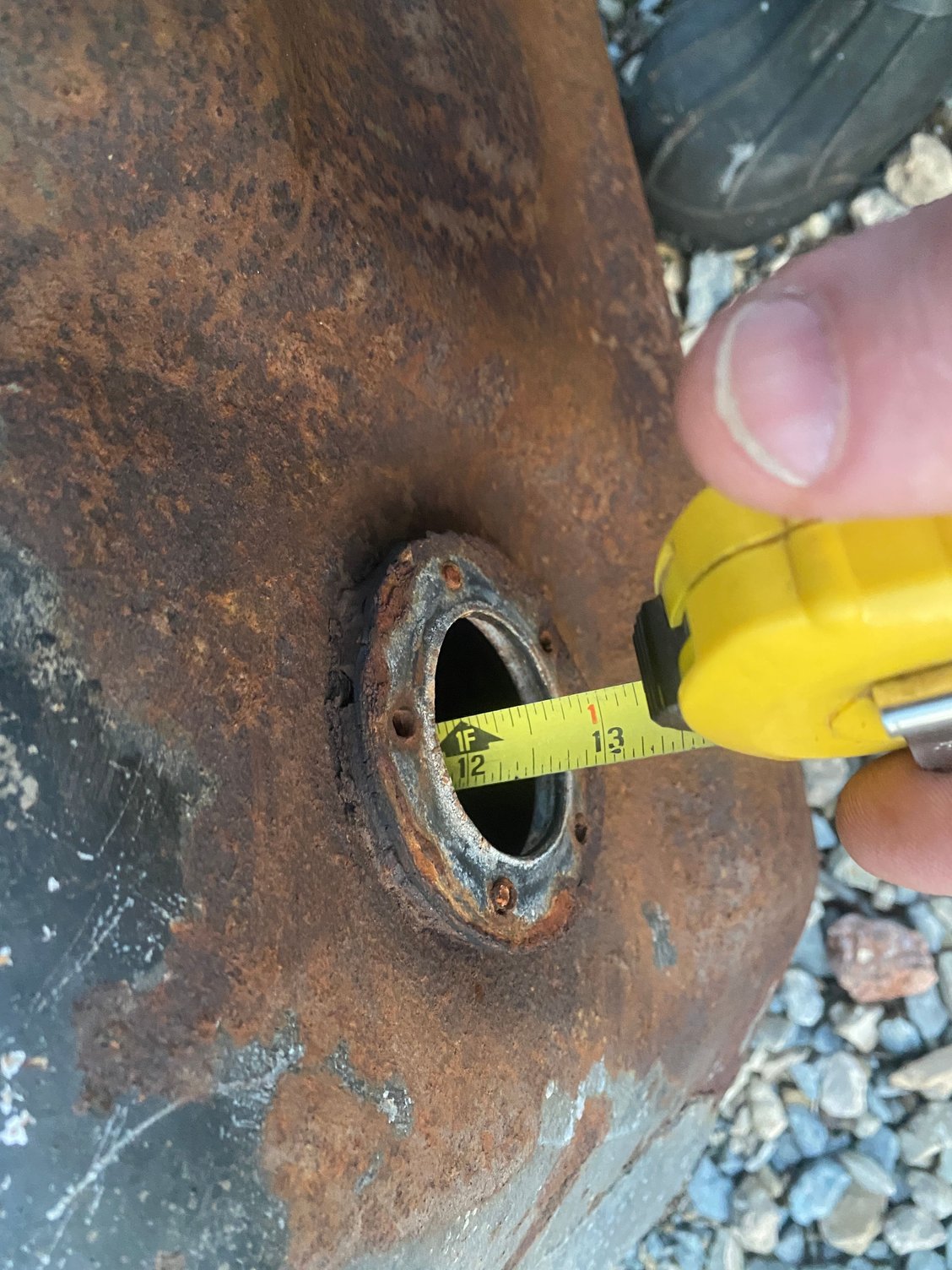

Sorry couldn't get to removing the pump assembly tonight. Yesterday I tried starting it for the first time and that's when I discovered the old bracket wasnt going to work, sprang 5 different leaks out of the hard line coming from the pump, sprayed all over even on the carpet (had the access panel open). But the top of the tank was dry as a bone when I left it last night, and almost 24 hours later it's dripping fuel and the top of the tank is wet. Not sure why it still had that much air pressure 24 hours later to make it leak? I did relieve the pressure at the charcoal canister to stop the leak tonight.
ANYWAY I did get a couple measurements for ya, from my old sending unit, from the bottom of the float to the mounting plate is about 11 3/4" (I know the pic looks like 11 7/8" just trust me) and measurement from bottom of tank to top is about 12". The other part of my original sending unit is broken off and laying in the old tank so I am not sure if it hangs higher or lower than the float?

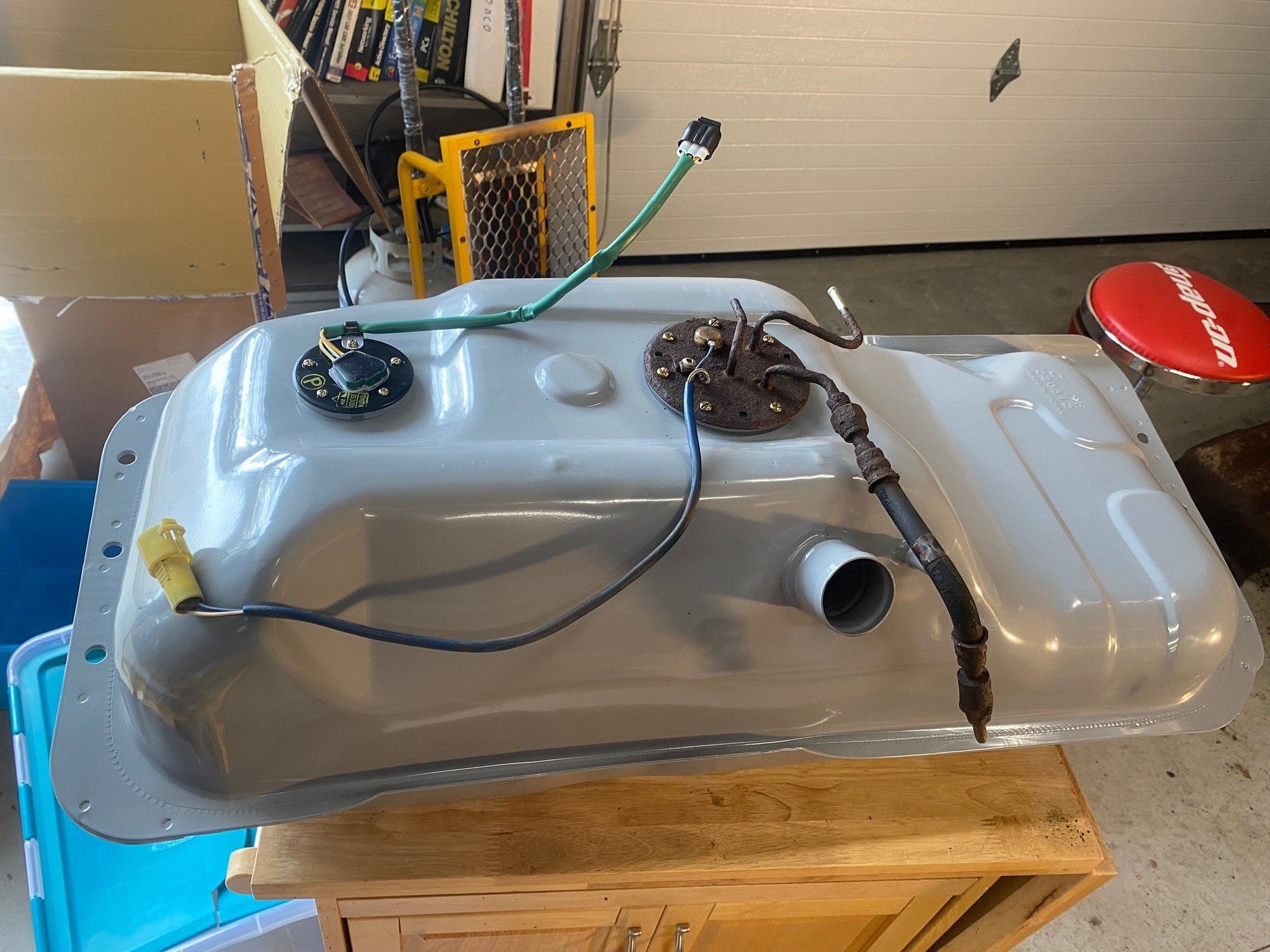

I chimed in on this thread because my drain plug was stripped so I could relate, sorry it didn't help much! here's my new tank, which will soon have ALL new parts. I should have known that crusty thing would fail, but i knew at least I wouldn't have to drop the tank again to replace it...do the 2nd gens still have that access cover in rear floorboard?
aye man you still chimes in and helped a bit, wasn’t for nothing.
we only have access for fuel pump wiring connector and the fuel line from the access panel, not the actual fuel pump which sucks but whatever. This thing gets driven a lot and I have never had fuel pump issues so I’m not worried about replacing the guts in my tank. I think I’m going to hit my local pick a part this weekend and snag a tank. Can’t really wait the two weeks to get a tank from rockauto right now. So I’ll probably do that and let my old tank dry out for a few weeks then weld the crack in it. The epoxy I slathered on it on Tuesday didn’t hold and started a slow drip again after I got home yesterday. I crawled under there in the snow and spread some more seal-all around hahah.
