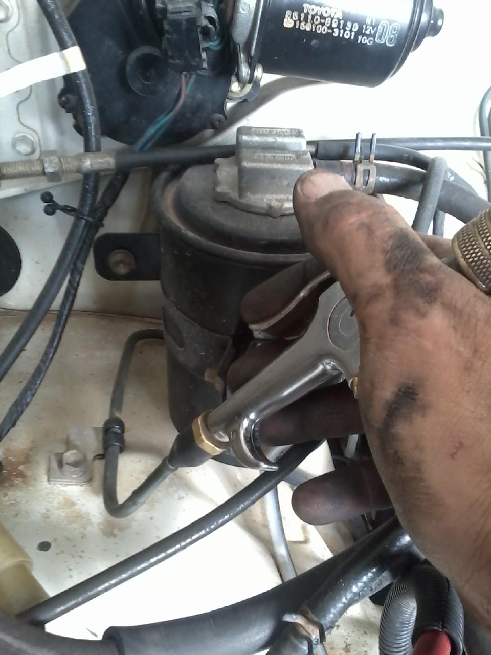

Also while doing the fuel system, check your charcoal canister. The vent line can get clogged with mud and I just use a drill bit and then blow the line out to clear it. I have replaced two canisters in the past as they will fail a test according to a Haynes Manual and you can tell quick when it fails. I forget how to test it but it is easy.

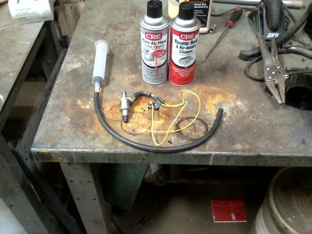

No problem. To clean and test an injector, I use a syringe, rubber hose, a 9 volt battery and some wiring. You can run just straight wire but another set of hands is useful. Even with my contraption, I still have to use a vise to hold the injector and one to hold the syringe and with 1 or 2 second touches of the battery to open the injector. You can connect the rubber hose at each end of the injector to flush both ways. Normally I use carb or injector cleaner but have used these in the past for a flushing agent.
