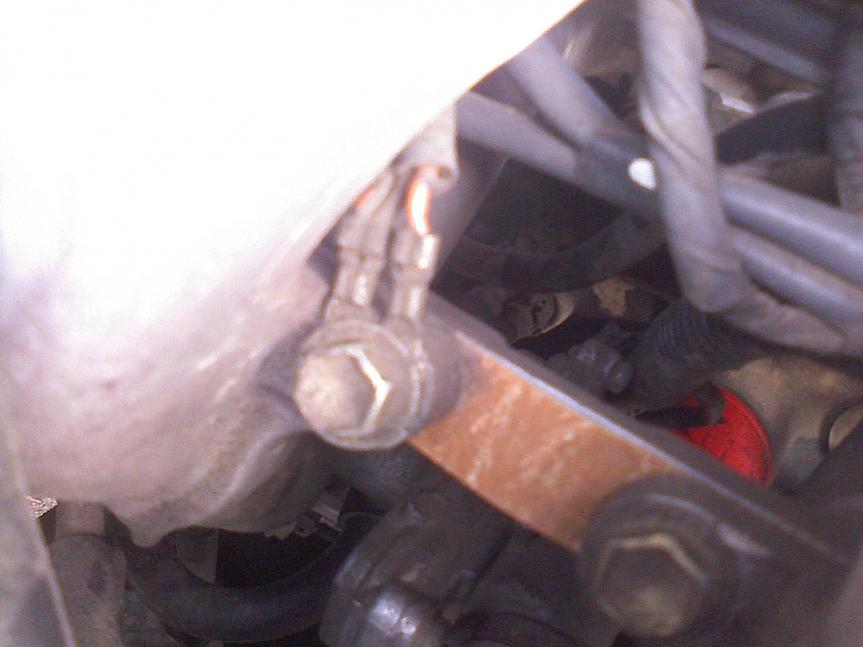

Is the fuel injector ground attached?
Intake manifold - upper plenum - attached to the #3 runner on the #2 side, if that makes sense.

#3#2????????? engrish pwease

oki checked and the fuel filter was reversed so i fixed that but its not injecting, the plugsare still dry after i crank the motor. im really confused here it might be the ground, im gonna get my dad to look at it he is a Marine Diesel Mechanic, so he might be able to help.

This one - looking from the pass side where the upper and lower intake plenum meet.
