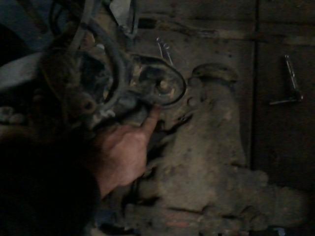

With the motor in and you drop a bolt and unable to find it. Most likely place that it is going to be. This is a hard area to see when the motor is in.

So the mystery of the 22RE "black hole" has been solved. LOL
