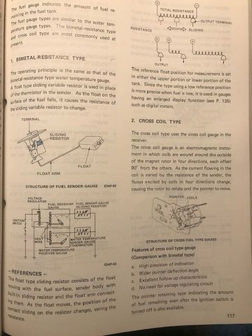

I dunno if this will help. This is from the book that Toyota gave to techs that attended their Body Electrical technical training course back in the late 80's-early90's. I just used my phone to take images, if you need better resolution I can scan and repost. I was just being lazy.
First, as I mentioned before in other threads the FSM is a little hazy when it comes to diagnosing electrical issues, especially anything to do with gauges. Now, the tendency bitd was to have tech condemn a perfectly good gauge based on the readings(especially anything based on ohms readings). But it wasn't too often it was the other way around; giving the thumbs up on a bad gauge.
The last picture is from the 1987 FSM. I find the wording "vibrates" interesting. They're assuming you're using a analog meter to test, not a digital. I wonder what the needle would be doing, as opposed to the digital readout jumping up and down? When I was diagnosing my oil pressure gauge per FSM I had a issue with using a digital meter when testing the sending unit. Just a thought.

Jimkola:
Maybe the idea of "vibrates" lines up with what I am seeing with the voltage fluctuations. It did look like it was centering around 4 volts now that I think about it. Thanks for the pics. I would love to have a copy of that manual if you might know where it can be found.

The manual could be a tough find, but every dealer tech attending the factory class was allowed to keep the book, so you might see it show up on eBay from time to time.
The Publication #STI018E (or in lower case sti018e)
I've thought about getting a analog meter just so my readings are more in line with the FSM
