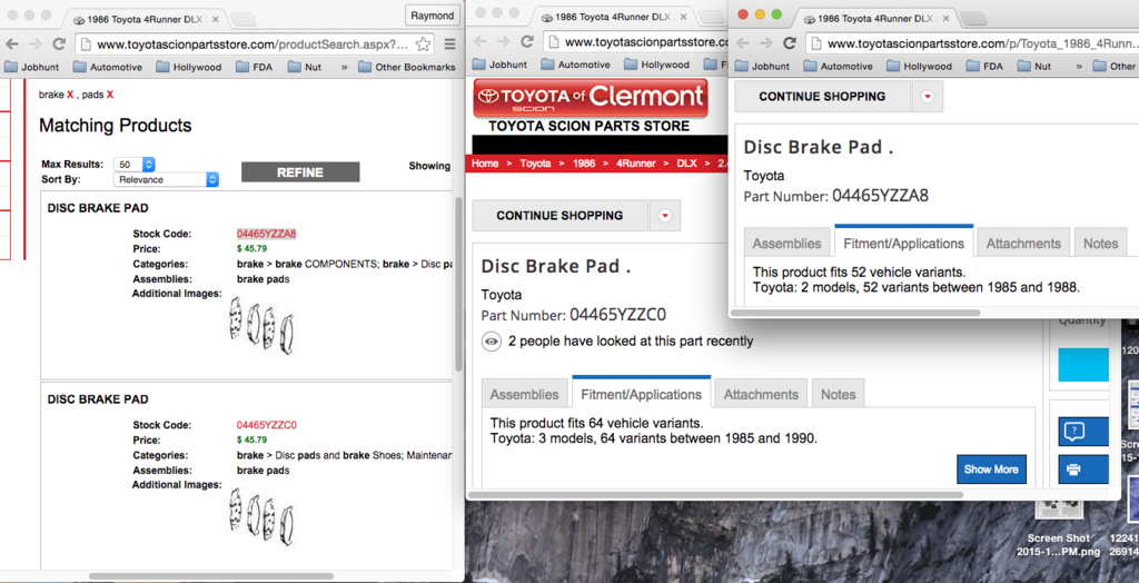

Hi guys,
Would like to ask for your opinion.
Many online stores list different part numbers for front brake pads that are supposed to fit the 1986 4Runner, like the one below (lists "04465YZZA8").
Should we stick with with "04465YZZC0"?
Is there a difference or are they physically same?
