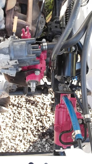

Got my new steering gear all cleaned up, painted fire engine red, time to pull and swap the Pitman Arm,
rent the puller (all goobered up in itself) so bent up it was almost unusable, made sure they notated the receipt at O'reilly..
Going to pull, just cranking away, huge strain on it. I know about pullers,
worked on millions of dollars worth of submarine feed pump motors and bearings at the age of 17-19,
learned from the true geniuses, The Master Chief!!!
Anyhow, why won't this thing let go?? Noticed something I haven't seen since the 90's White Loctite!!
Never, ever put white loctite on anything you want to ever get back apart w/o destroying.
Lucky I still have my propane bottle after tossing the grill, had to sit for about half hour
cooking it way up over 500-600 degrees or higher with the torch, watching and praying the relay rod joint didn't start cooking,
finally with a huge snap it popped loose, had to chisel off the remainder, cleaned it up, good to go!! Don't use white loctite goobers!!!

The front end is DONE!!
New camera arrives today from Amazon $72 vintage Kodak 2012, so pics on the way. New Axles (thanks wyoming9) 2nd one easier than first, new shocks all around, new swaybar supports, and nice and clean underside, new paint in the engine compartment, steering going back in today, no more steering wheel free spin...first time it's on it's own 4 wheels in about 5 weeks, basically back into assembly mode as opposed to disassemble mode.. Changed the "not remove gasket" decision, when the driver side is back together, on to the passenger side, removing TB and Plenum, sending them out for a $30 ultrasonic cleaning as opposed to 10 cans carb cleaner and a brushNow we're cooking with gas

The camera shows up, the steering is finished assemblywise anyway.
Won't be running for a while yet, according to Haynes (ooh ooh) I run the steering full range a few times engine off, then run it engine on under 1K rpm, same routine, thinking about hooking a drill to the pump shaft and spinning it up for a while (of course in the correct direction), or maybe I'll just wait.
Gear and pump sat inverted for couple weeks painting and other wait time, so I did add some fluid to both during assembly, never was dry enough to rust or anything. Somebody had been in there as the steering wheel was off a significant amount, reset to proper position, perfect range stop to stop (4.25 total turn range divided in half for center) not a drop of leak after fluid just pouring out of the column seal and bearing originally. So the whole driver side is now clean and new looking except I'm not going to paint the block, nice clean cast with rust tint will do. Can't even get close on cleaning underside of the plenum, .25 inch of crude just won't budge and can't reach to scrub and scrape so they're being pulled and sent out for $30, from what I see, the inside of the plenum looks like a 35 year smoker lived in there.
Also pulling the valve cover to clean and a nice bright yellow paint job.
So much for not pulling gasketed parts, but it's going so well, confidence increases, this be fun!!
Still have the transfer case shifting issue, suspecting improper internal parts positioning during a previous repair, hopeful.. Otherwise, it's only my time to get it repaired, no big deal as long as it's done before it gets too cold again. I want to keep the gears as opposed to getting a chain drive..
