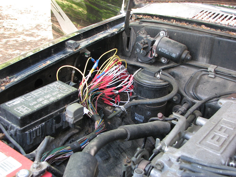

Well, the weather has conspired against me somewhat - but here's what 41 spliced wires looks like:
The good news: It runs. Purged the fuel tank, swapped the filter, new plugs and wires, changed the oil. Drove it 2 miles.
The bad: Doesn't run right. Idles fine, power is good, but at cruise it bucks - so I'm thinking EGR. Flooring it reveals clutch is slipping, and the oil leak I have might be from the rear main seal. I decided if I was going to have to tone out every wire, I might as well grab a new harness and get it done right.
But that's put me into a corner now. Trying to find a harness is being ... annoying. yotayard.com said they had one, then I called, and they don't. Anyone else have good resources? Thanks.

You guys should've told me it was this easy.
I found the junkyard post ( https://www.yotatech.com/forums/f123...-yards-149035/ ) and started calling around a few weeks ago. Wasn't as easy I had hoped, I ended up calling about 20 places all told.
First though, a big shout out to Victor's Off Road Engineering - he was the only yard I called that kept me on the line while he checked through his stock, and when he found a candidate we would read thru the wire colors on the plugs - but we couldn't find a direct match. If I need something else, I'll definitely be giving him a call.
All Toyota Auto Recycling grabbed one off a 93 4x4 5spd. $210 after shipping - probably not the cheapest if I wanted to search more, but all in all not too bad. I got it Thursday, spent Friday night removing the old harness and installing the new one. All told, probably about 4 hours. New intake manifold gaskets, cleaned the runners a little, stripped one of the egr threads, breaking torque on one of the threads slammed my hand into the egr valve and took a chunk out of my thumb - but not too bad.
Took it for a quick test drive - it doesn't want to idle correctly, but it's not bucking at cruise anymore. Clutch is most definitely unhealthy, and I've got clean oil spotting the ground - rear main seal. Doesn't want to idle either - but I missed plugging in the coolant temperature sensor. So I'm hopeful that's my problem, about to go check that out and swap in some plats to replace the coppers I put in there while troubleshooting. Messed up and didn't call insurance till today - so now I have to wait till Monday to drive it and get title + emissions + tag.
Ohya - I'm up here in Grayson. Keep forgetting to mention that.
But, final tally is still < $500. Not too bad.

Toyota wiring harnesses are a nightmare. I went thru something like this with my 4R. The PO decided to hack the harness in a botched effort to convert it to a turbo model. What a mess. I found 3 harnesses at the junkyard and combined all three to get one good harness. The problem is that Toyota seems to change their harnesses every week it seems. Even the same make and year can have a dozen different harnesses. Bleh.
I'd solder, heat shrink, and re-tape the harness for reliability.

I did clean up and retape a bit of the shielding that was looking crummy. But everything was drop in. Yay.
But good news - 2 vacuum hoses, 1 vacuum leak, and 1 sensor plugged in - purring like a kitten now. Enhanced by the rusty muffler.
