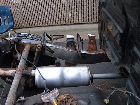

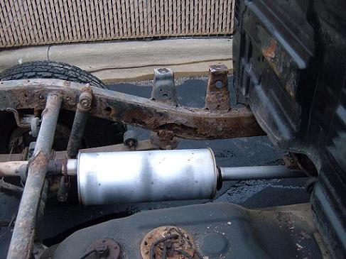

Here are a couple of pictures. When I get home from work I can post more from photobucket. Basically there is a bad part behind the cab that I cut out and ground down all the rust and now im fabbing up a new patch piece.
Heres when the bed came off
After the cut
Starting to fab new piece

Better pictutre of Rot
Another one of the back of the cab
Cutting the swiss cheese out
Its crazy how these frames rust when the bodys are good. And the frame has no rot from the cab up. Weird. Let me know what you guys think

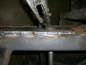

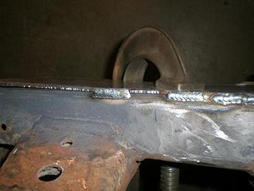

Well I got the Patch Panels welded up today and Im going to start prepping the frame for the rust encapsulator tomorrow. Check out the pics.
