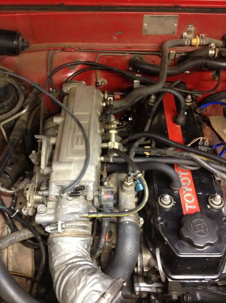

Here is the engine bay before beginning the project. Yours may look a bit different. Mine has suffered an EGR-delete and removal of other unnecessary wiring and hoses. Please excuse the duct tape over the cracked intake tube.

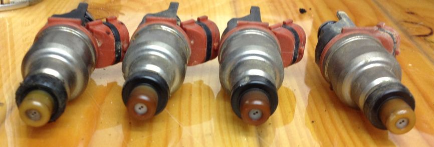

Here are the 4 old ones for reference. They were redone by Witchhunter a few years ago and still appear very clean:

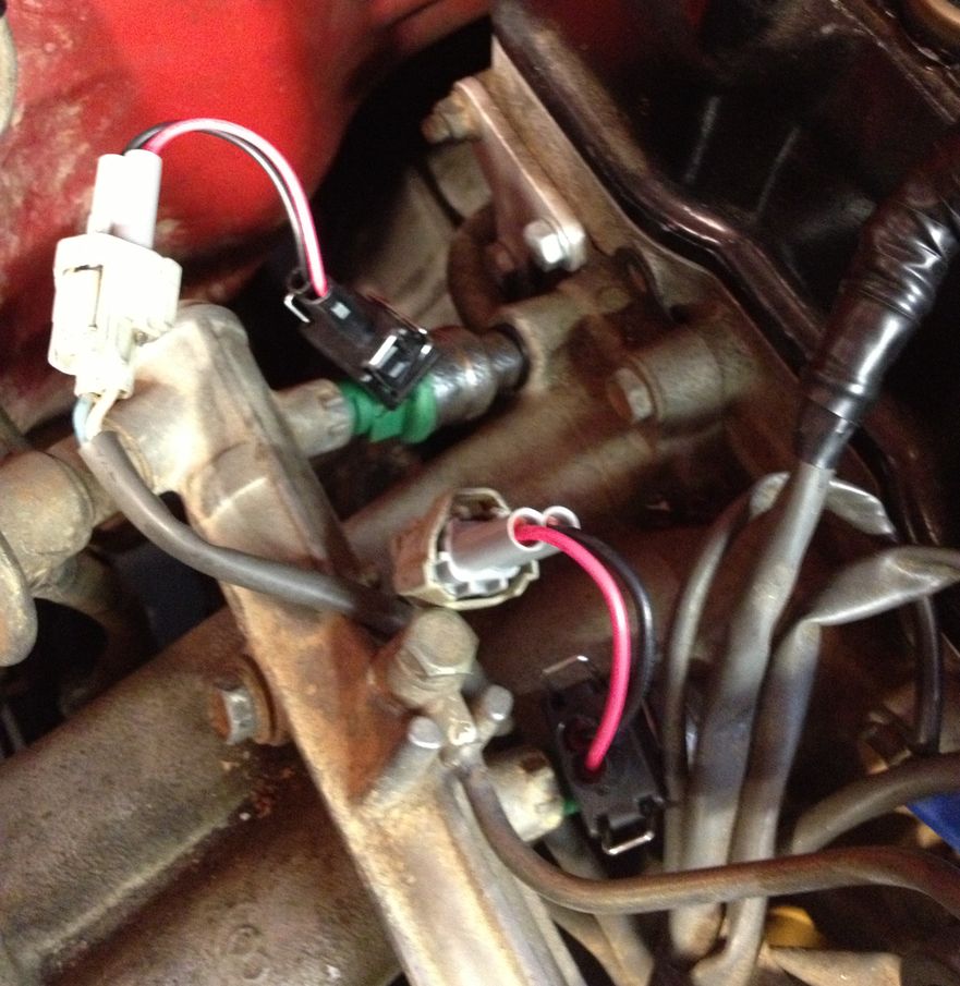

The flame thrower injectors come with jumper cables that adapt the Toyota injector harness to the different plug style. The quality of these jumpers appears very good. One of my harness ends was missing its retaining clip so I used a zip tie to hold the connection together.

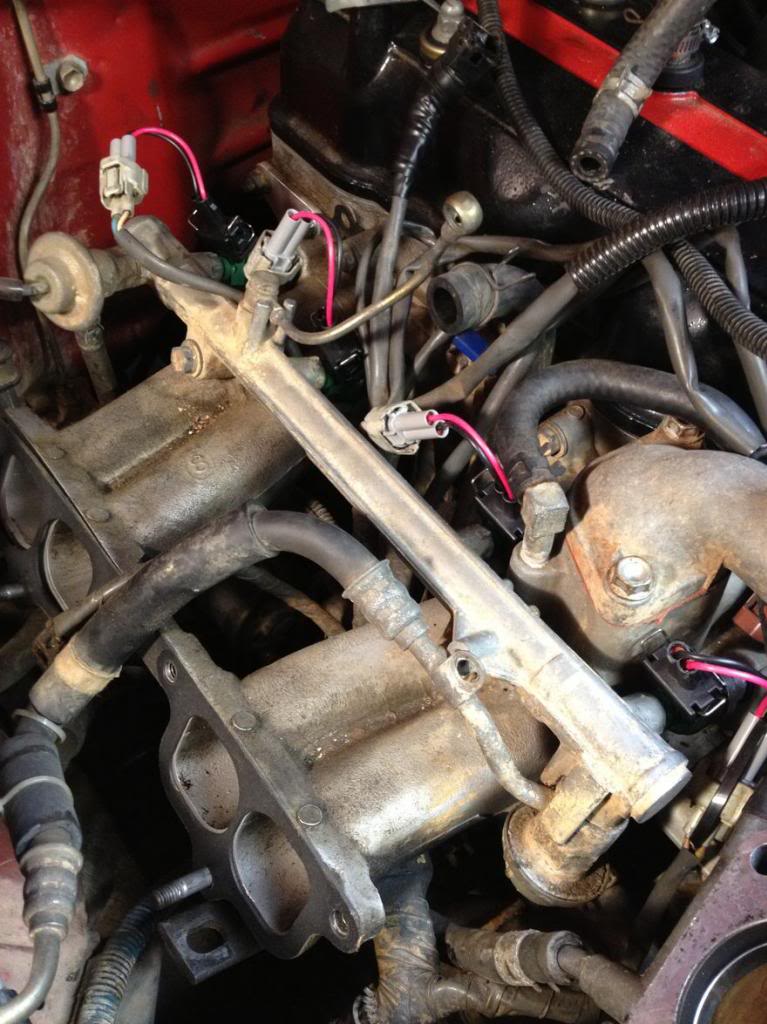

Here is a detail shot of the injectors installed:
