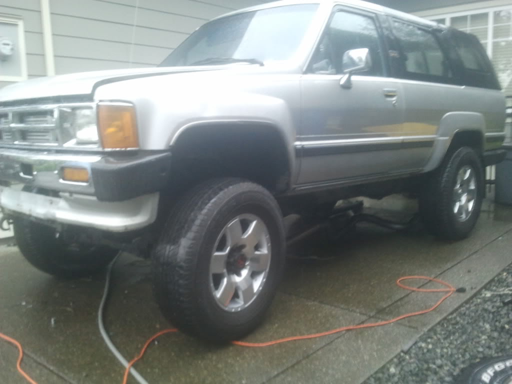

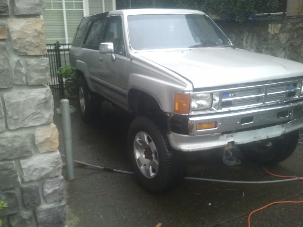

Didnt find much info on retrofitting newer toyota rims on our older rigs on here, so I thought id clear some things up.
Picked up a set of newer FJ rims, they fit perfect. They are hub-centric so I even got to re-use my lug nuts

They are actually 17" and the tires are about 32"

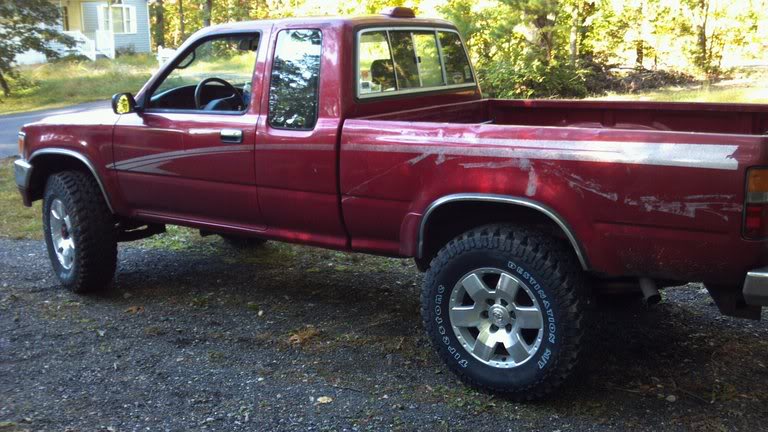

DO NOT use steel wheel lugs with alloy wheels! They require the flat-back lugs with washers. Pay particular attention to proper torque settings.
FJs on my '94

OEM alloys require a OEM lugnuts, the shank type with the washer, not the tapered end acorn style. OEM lugnuts are tapered on the end so they can be used on a steel rim spare if necessary.
Typically all OEM Toyota alloys will swap out IFS to IFS on 6x5.5
You have issues putting IFS wheels on SFA and need wheel spacers.
2011 4WD Tacoma OEM alloys on 95 2WD 4Runner
I need wheel spacers for the caps to fit in the front over the OEM wheel hub but other than that they look awesome. Best part the tires/rims under 1k miles on them for $150
