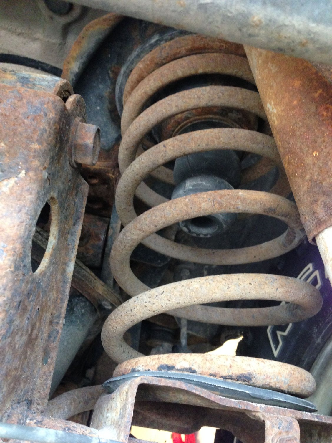

The old owner who owned it only for few months decided he wanted to mod it and jack it up. I have fixed most of his poor choices but may need some advice on this one. He has inserted 1 inch spring spacers in the rear and has literally maxed out the torsion bars. The spacers are not to hard to remove I just need to jack up the frame and let the axles hang and I should be able to remove them. But the TBs are not going to be so easy. Any advice is welcome.

Not a good picture but you can see the spacer zip tied in place.

I lifted the truck by the frame and was able to just pull them out by hand. Super dangerous IMOP
Removed. Now on to the fronts TBs. LCE had the TB bolt kits for just over $20
