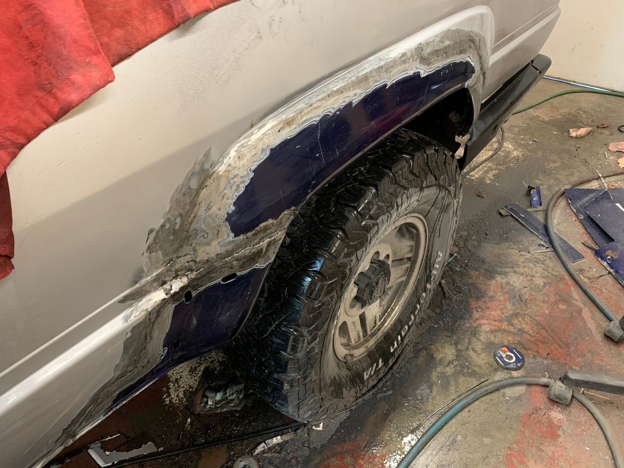

Personally I own an 85 pickup and recently installed some fibreglass bed sides. I had another set of fibre bed sides I did not use advertised and I guy came and actually bought them but when I saw he planned to pop rivet them into his 4 runner I offered to fix it properly using the metal I removed from my bed.

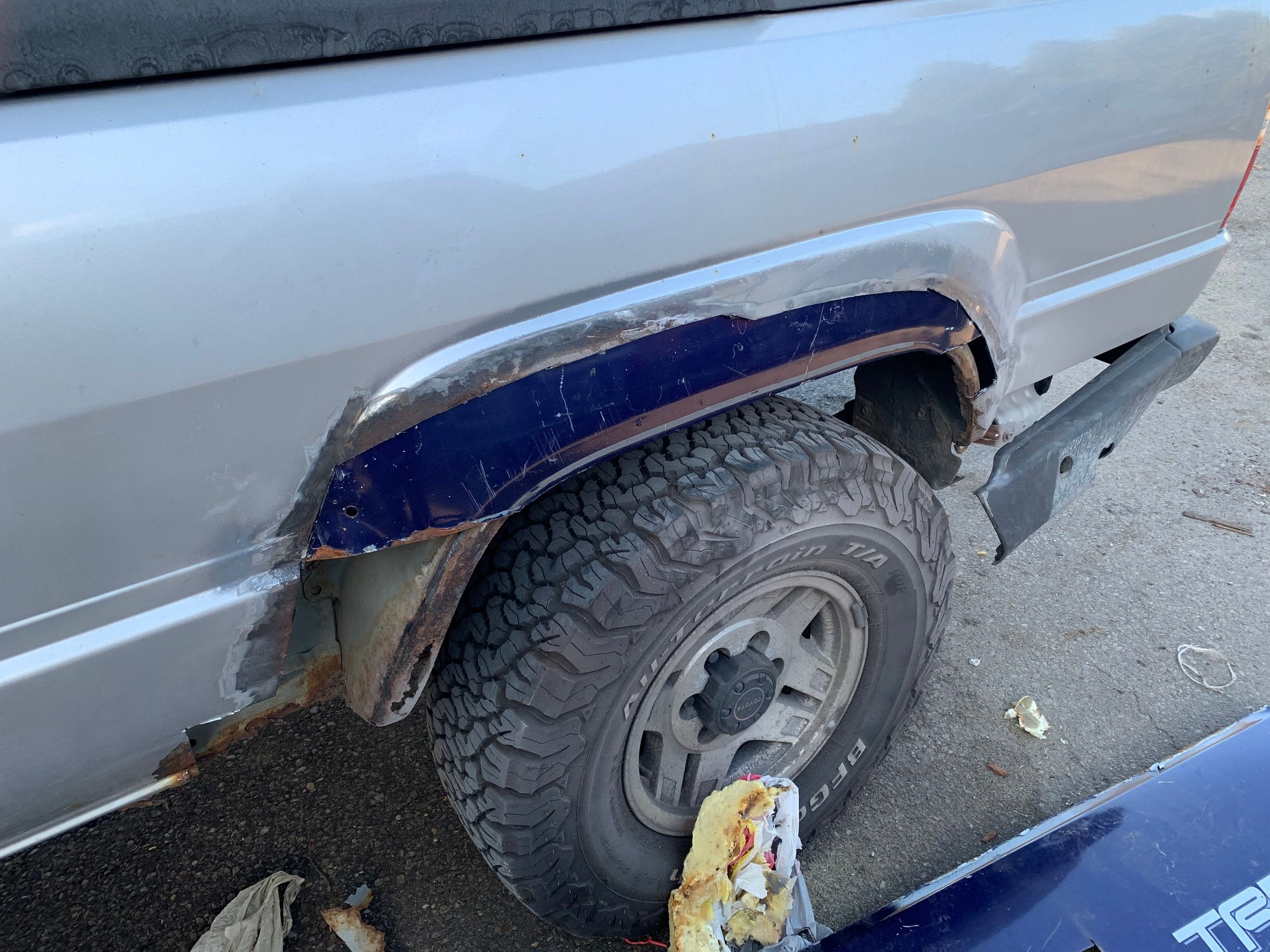

here is some pictures of the process of welding in the chunks of metal bed side to reform his very rusted out rear quarter fender openings.
it can be done if you have the patience

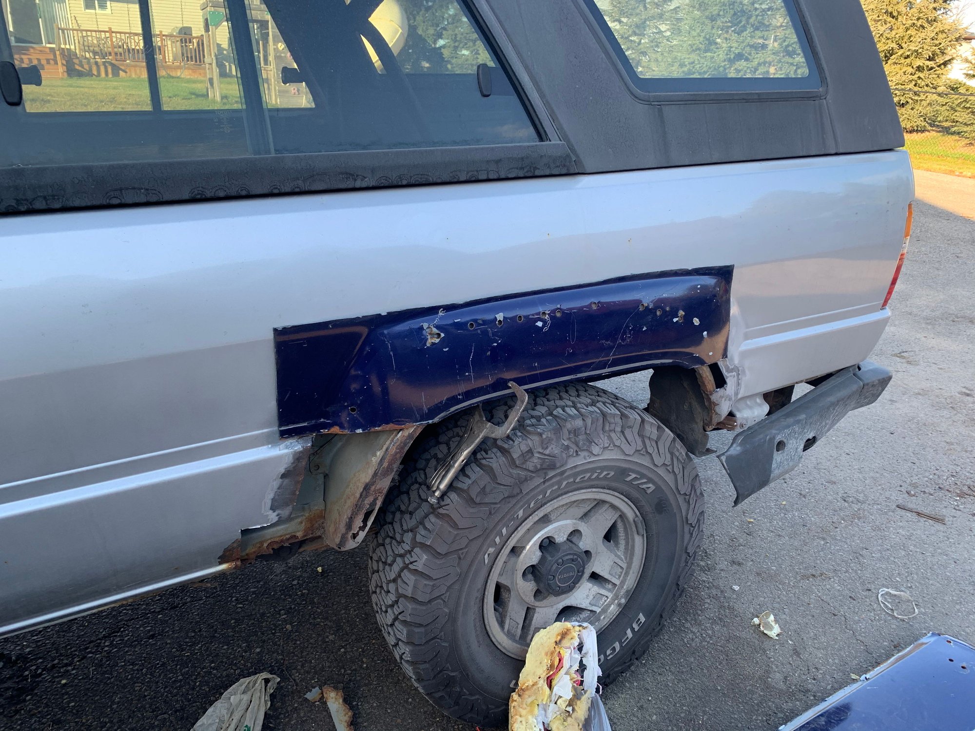

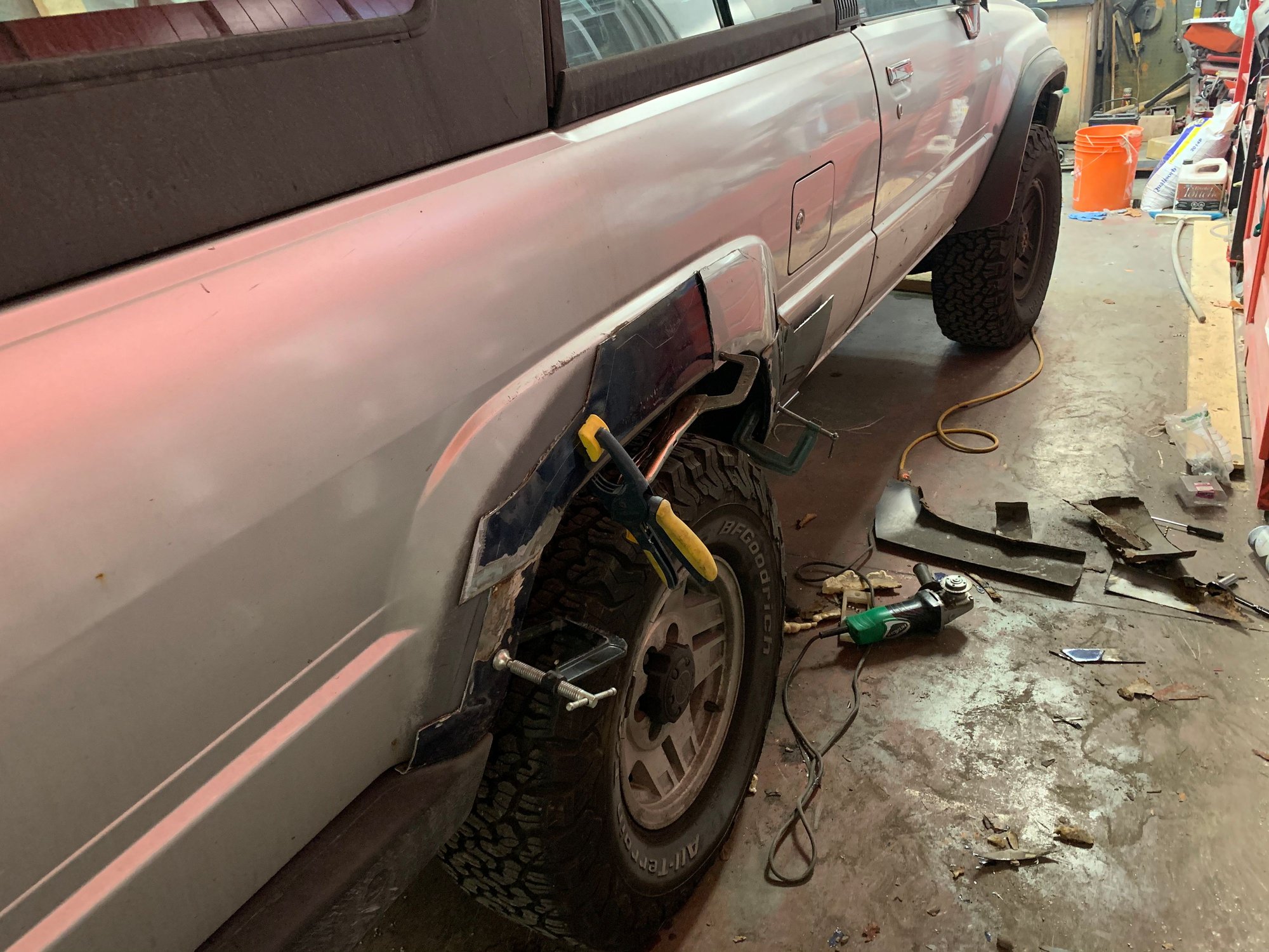

The rough overlay on the drivers side to check the fit
Tucked under to mark the edge of the gaping hole

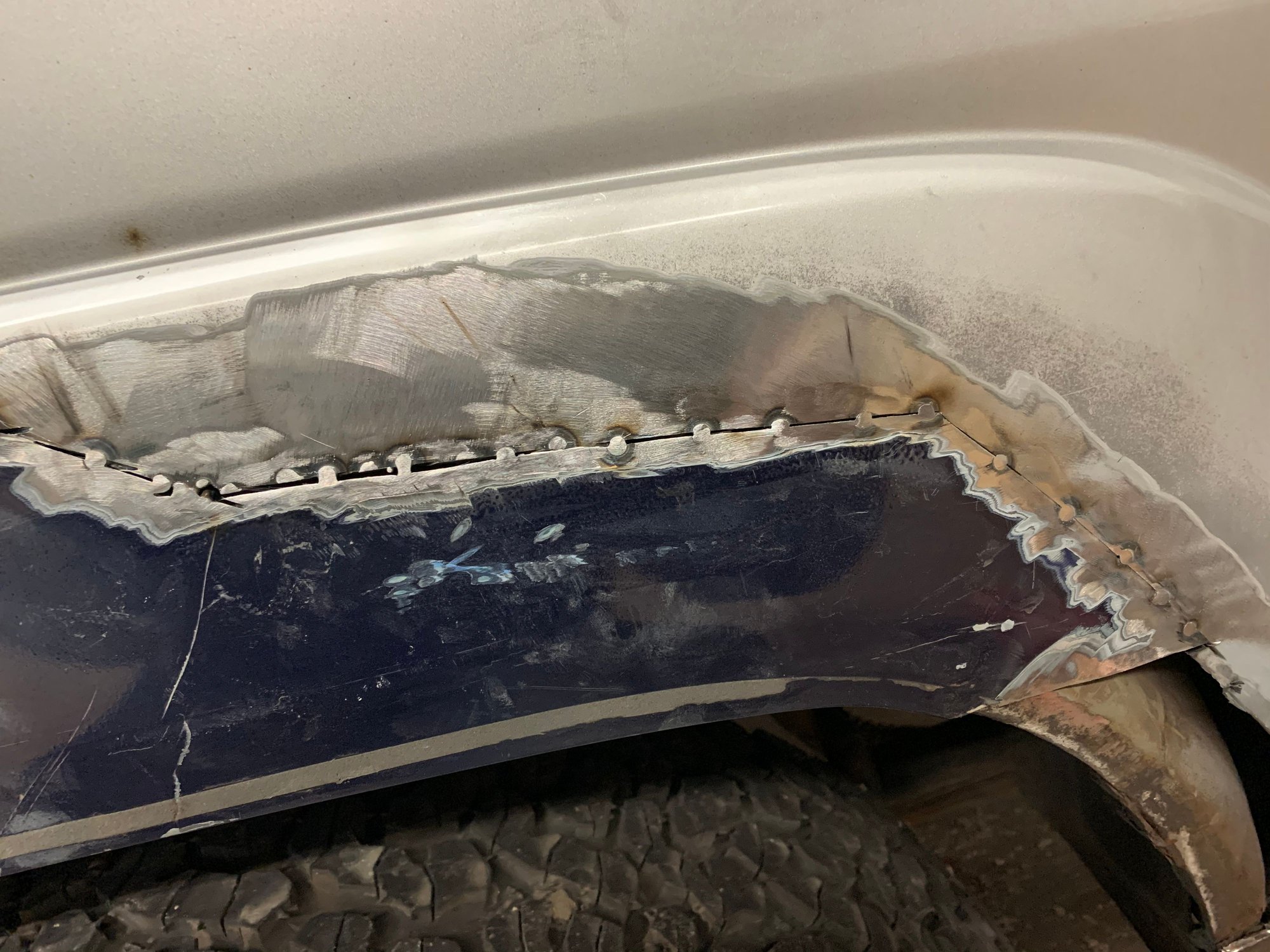

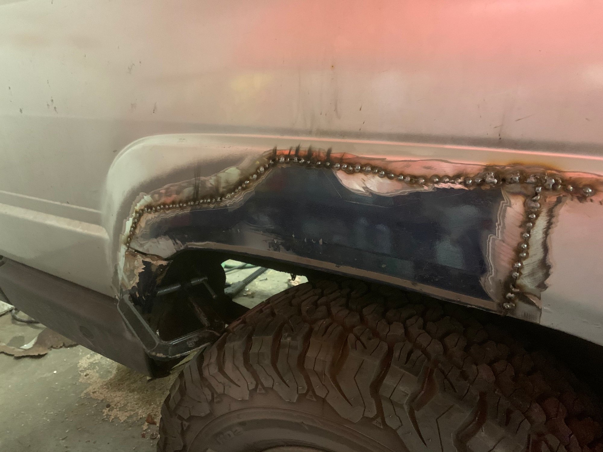

Tack welding the but welded seam
Almost finished welding

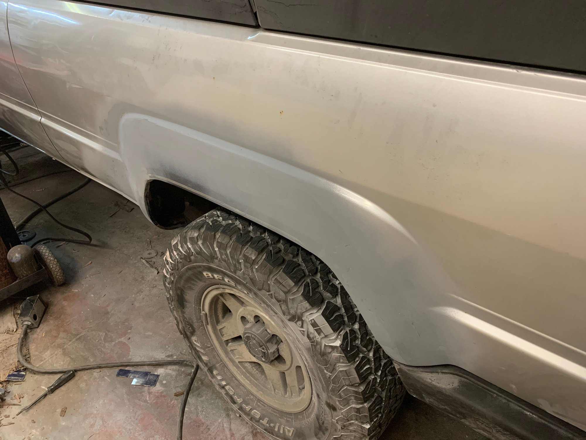

After a little grinding

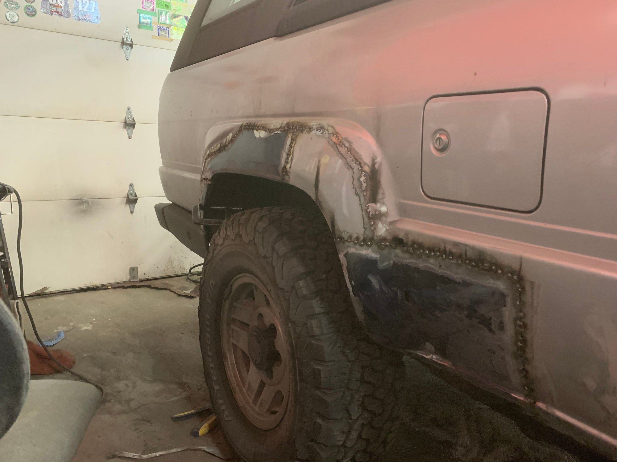

Started the passenger side
More welding

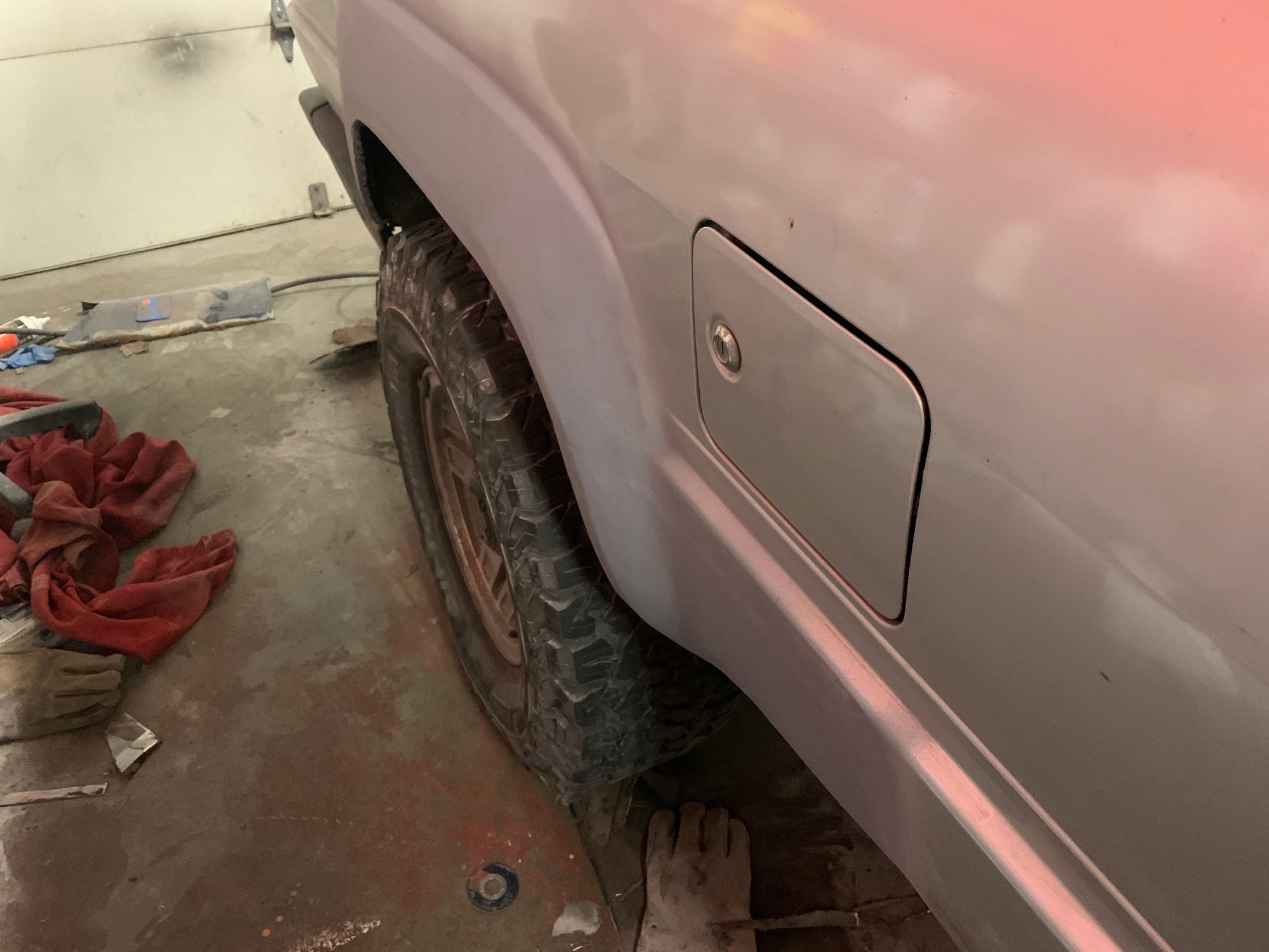

It was a big patch on this side and I had to splice in a piece of front fender where the gas door was on the bed side

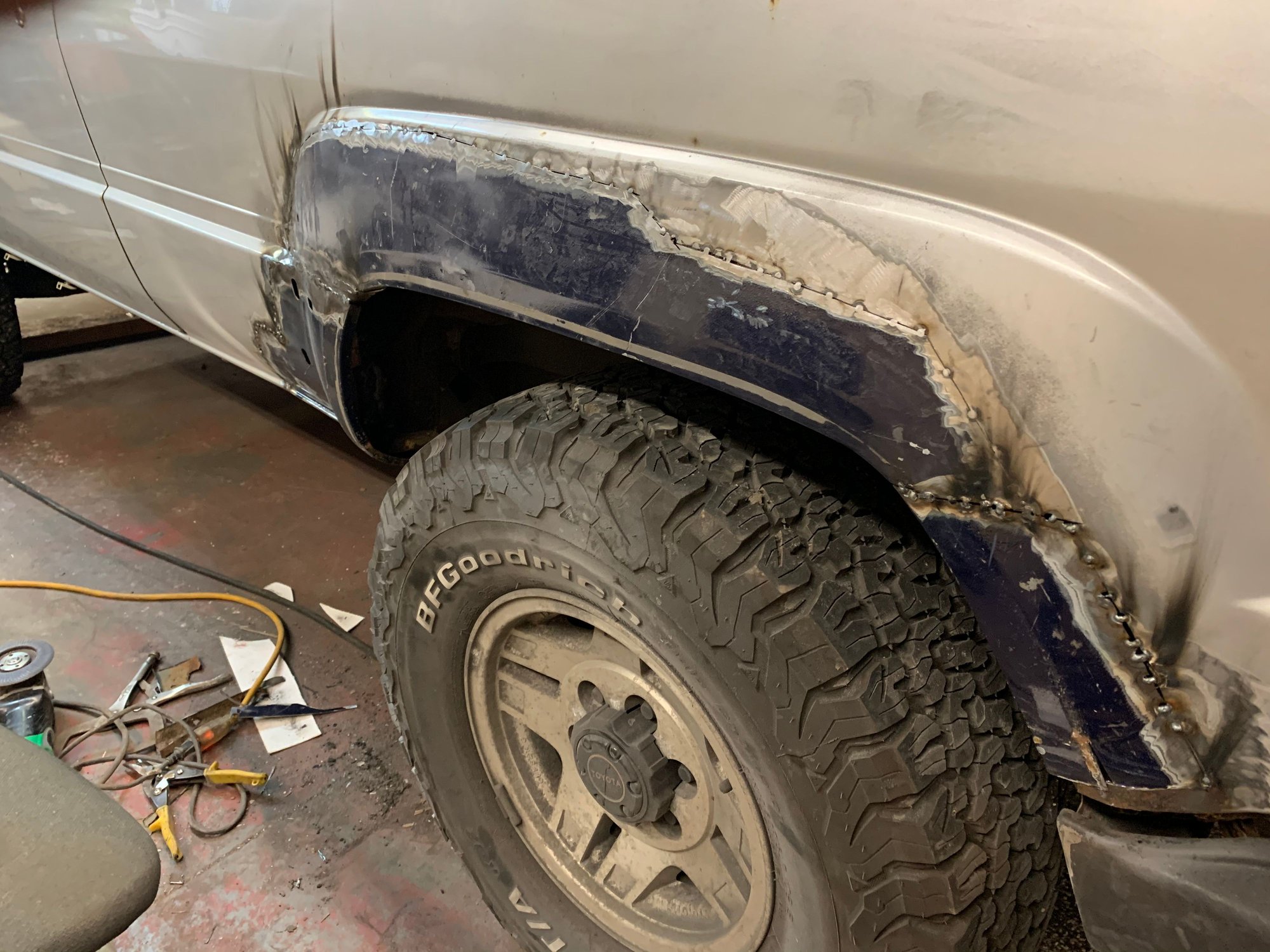

After a little shaping and a quick coat of primer
The finished passenger side

Im curious. Did you treat the back side of your welds against rust. Im not a body man but I am a welder.

Sorry I have not been active on this forum recently but to answer the questions.
I often use weld though primer which I did use on parts that the back is not exposed after the repair is complete. Almost all of this repair was accessible by some means when it was done. Some from the inner cabin and most from underneath.
The truck went to the body shop after I was done and then the owner was planning to oil spray the inner panels with rust check (only do this AFTER you get it painted!!)
