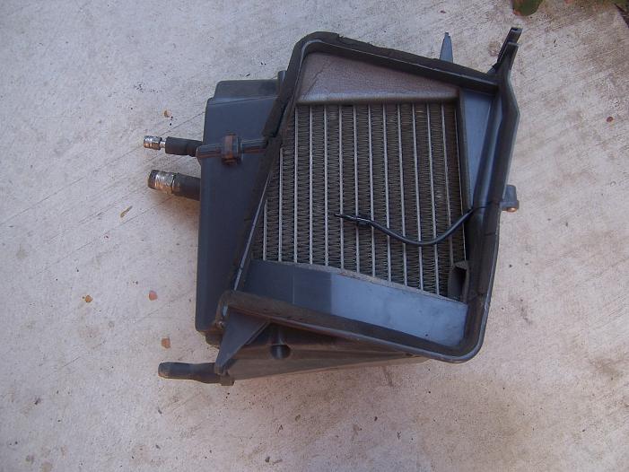

Does any one know if the 1st gen runners without A/C have a different evaporator case , or is the case the same between the ones with A/C and without A/C, just missing the A/C parts .
I need a place to put my engine computer and since I am not runing A/C anymore would like to switch this case out if they are different.
I really dont want to have to customize the one I have .

here is a pic of the case with evaporator , if anybody with out A/C can check to see if its the same would help alot , thanks !!!

Trucks with out a/c don`t have an evaperator case, there is a plastic air duct that goes from the fan housing to the heater box. You can find this piece on any truck that doesn`t have a/c.
Thanks Alot!!!
on the hunt Now ..
