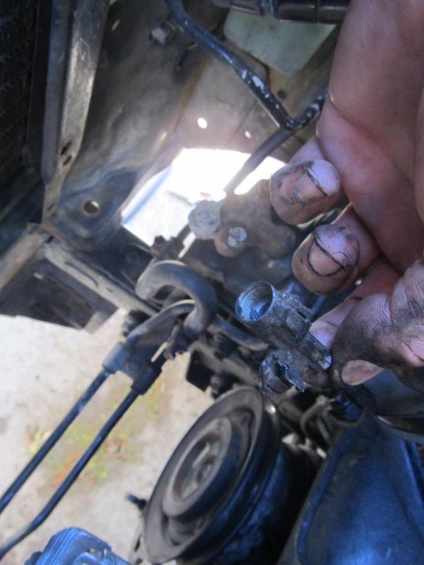

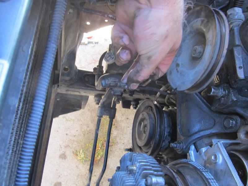

I am finishing up a clutch fan bracket replacement on my truck. Everything has gone very smoothly and the rockauto aisin bracket lines up perfectly. I ran across this single wire probably for a sensor, and cannot determine where it goes. Any help is greatly appreciated

Air conditioner compressor?

X2. How many wires are on it?

Sure looks like the AC. A single wire, which ends up right on top of the compressor.
The other end is in the bundle that goes fore/aft right underneath the battery, with the connector just aft of the battery.

Thanks for the help. It looks like the wire is coming from right on top of the compressor (hard to tell but that seems like the direction) with this loose end being the one that goes near the battery. I should have waited and tracked down were it goes before reassembling everything else. I havent had ac in the truck for 4 years , so not too worried about it, but still will track it down and find the right spot.
