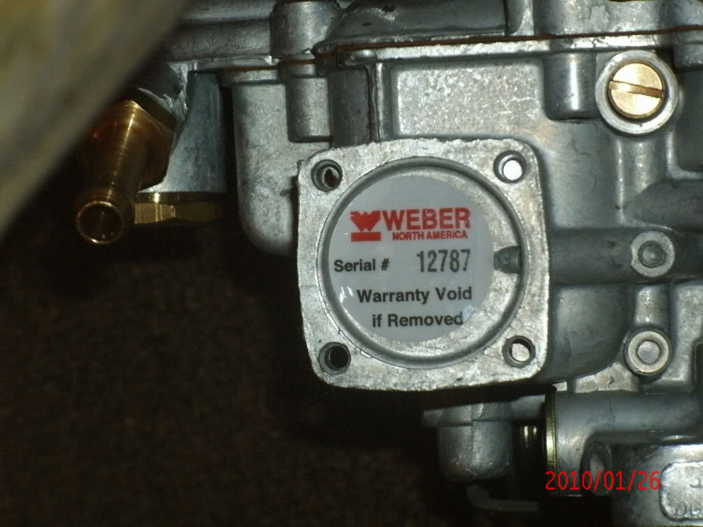

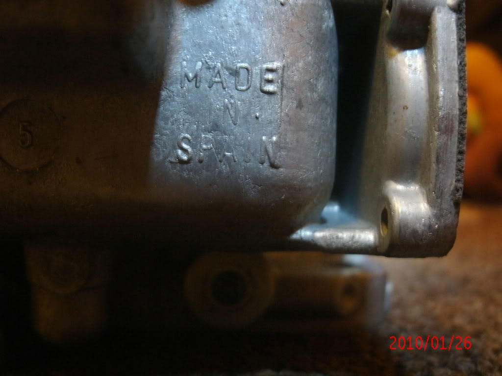

a real weber will have these markings (mine is from webercarbsdirect.com cheapest kit online.)
If you see Solex or EMPI anywhere on the carb it is not a real Weber. Also stay away from the 34/34 as it is either a solex or interco carb as well.

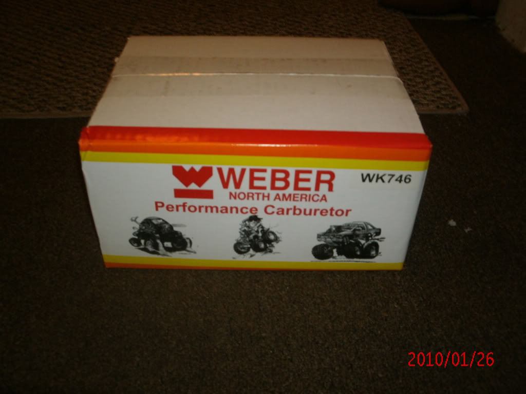

and the box it was shipped in:

that's the cleanest Weber I've EVER seen
another give away on a lot of fake ones that I've seen is the fuel inlet. They should be angled down like the one pictured above, and a lot of fake ones I've seen have the inlet's facing directly to the side

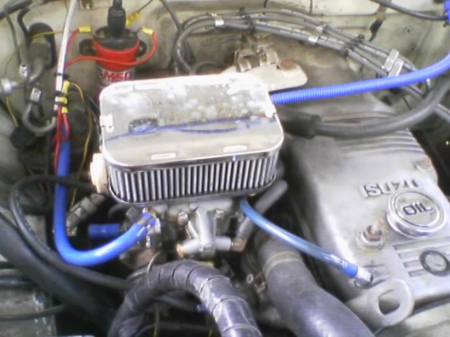

I had a 32/36 once... on a modified Isuzu motor
I think I rebuilt that carb like 4 times in the coarse of a year...

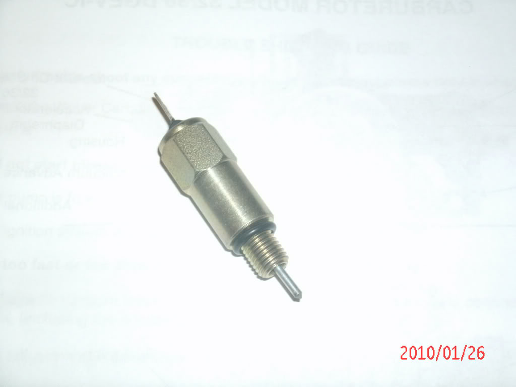

the cut-off solenoid i had had the jet holder and was not a part of my kit.
I took the jet out of the original holder and put it into the solenoid and screwed the solenoid into the original hole and discarded the old jet holder.
I have yet to re-jet mine, but I need a larger one ad my idle mix screw is out more than 2 turns.

hahah that's because it was brand new, you should see it now. haha.

I don't think you understood me right, I used the same jet that came with the carb when I added the solenoid. I did not have to get different jets to run the solendoid, nor did I have to use the solenoid to begin with but glad I did, because mine deisels every now and them because the wire connector on the sol. broke on me and I had to hack off the plunger to keep the fuel flowing to the carb. Stupid me lost the original jet holder.
