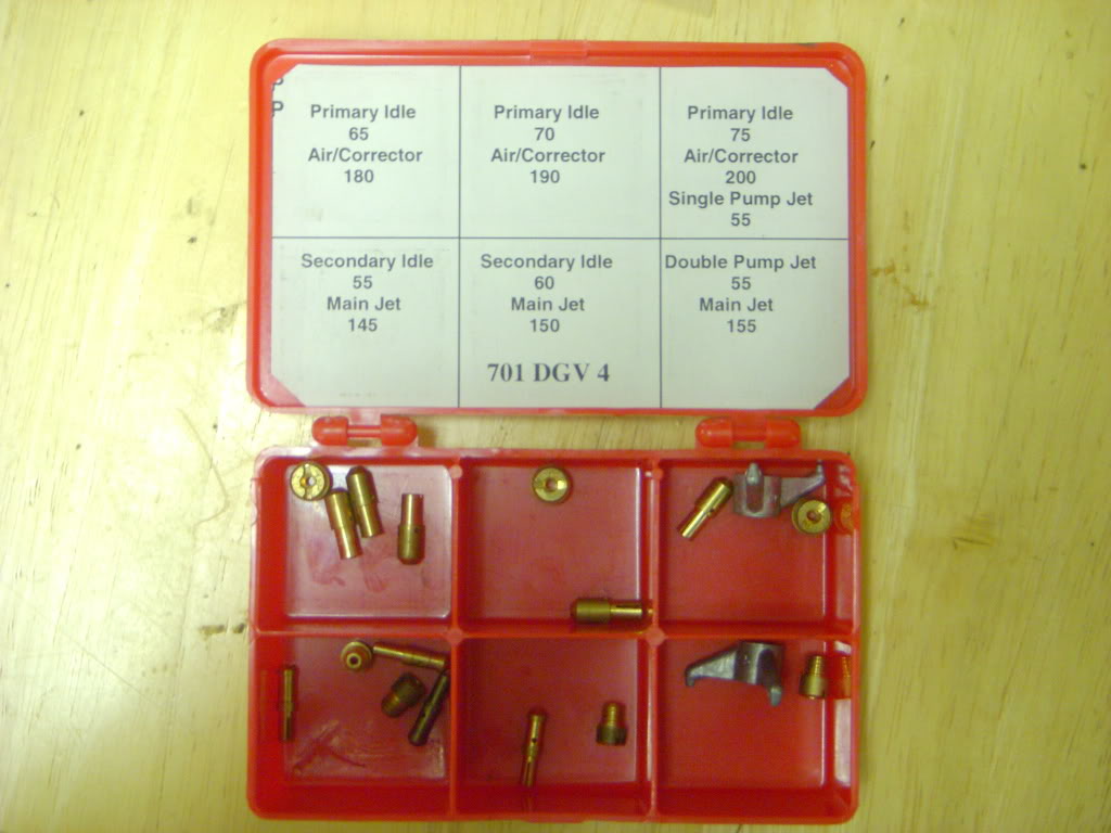

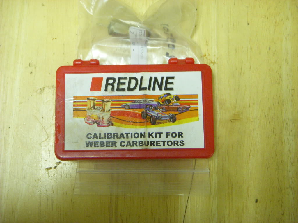

I just tinkered with my Weber today, and as far as I know it's a DGEV(electric choke and a 32/36, but I bought it second hand from a buddy) and the primary idle is fatter than the secondary idle jet. In my tinkering I replaced my idle solenoid deal cause I never hooked it up(yes, I had to do some strange stuff to get it to idle with the solenoid there but not hooked up), and the new screw style jet holder held the fat primary idle jets just as well as the solenoid did. I received all my jets and tuning stuff from LCE, though the jet kit I bought first came in a Redline case.

Notice the different primary/secondary idle jets

This photo confirms what I had said notice 701 DGV4 which is for the DGEV/DGAV and not the DGV which would take the 701 DFV kit. Looks like I don't have to go looking for the jet part numbers.
Originally Posted by xxxtreme22r
as far as I know the primary idle jets are different between the DGEV/DGAV and the DGV. does not matter of the solenoid.
Jet kit 701 DGV4 for the DGEV/DGAV (water/electric choke)
Jet Kit 701 DFV for the DGV (manual choke)

DGV 4 means 4 cyl, DGV 6 means 6 cyl, other than that the numbers mean nothing. your jet kit would be the 701 DFV unless you needed other jet sizes that might not be in the kit.
DFV and DGV (manual choke) share the same jets.
DGEV = electric choke
DGAV = water choke
DGV = manual choke

those two I posted shows both have the same jets too, the smaller ones. but one is clearly the manual choke.
