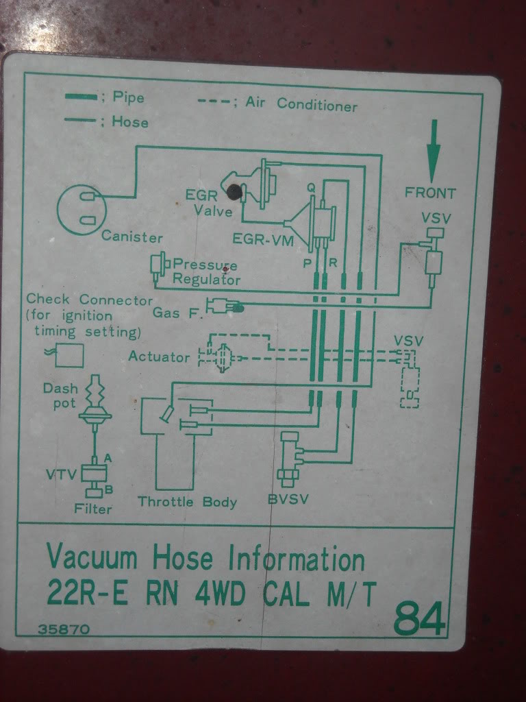

Regarding my Failure of 25MPH NOX-PPM in CALIF.(Very close to failing NOX at 15mph as well and TOO close, as well, on the 15MPH "HC" portion IMHO)...........Copy and pasting some posts/info thus far from my own "CA Smog Test Failure" Thread.... Link and 'nit pick posts' below>>>>
https://www.yotatech.com/forums/f116.../#post51904889
* Emissions Vacuum Routing checks out as directed by FSM and Hood Sticker
* Ran a couple tests with Vacuum Gauge + More >>>>>>>

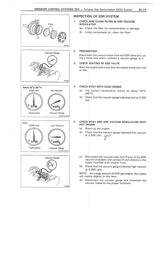

In EC-13, #1, the Modulator appears to be clean still. I will blow it out with air, regardless.
In EC-13, #2 and #3,.... I verified it started.
In EC-13, #4, .... I think in moving out to the driveway I got it above 86*F (However, it was under 2" vacuum at 3500RPM, much lower than it was in step #5, warmed up)
In EC-13, #5, Steps A and B .... I warmed it up for several minutes and tested as instructed; It showed under 3" Vacuum(Maybe 2.5"?)
In EC-13, #5, Steps C, D ...Hooked up as instructed and found 15-18" Vacuum as I hit 3000RPM(give or take)
In EC-14, #6, .... I had done a video of this... I applied direct vacuum to the top of the EGR... The motor DID, in fact, want to die, quickly.(Whether at idle or 3000RPM)
in EC-14, regarding the "BVSV" portion.... Cold and Hot.... It passed both tests.... "Blow air into the J while under 86*F(I did it when cold) and be sure that Air passes through the J(lower) port and out the Top(basket/filter).... Then, warm up above 111*F and you should be able to blow air into J and have it come out K port(Upper on the BVSV)".... As I said, passed both tests with flying colors, no resistance, etc.
In EC-14, Modulator Portion.... I'm NOT SURE! I tested by blowing air while not running, through "Q", while plugging up "R" and "P"..... Seemed air flowed out the top/filter ok. In the second part of testing, "Run at 3500RPM and repeat the previous test... Resistance should be dramatically increased"(shouldn't be able to blow air through it really well while plugging R and P and blowing into Q). I also noticed that the Filter in the Original is MUCH dirtier than I thought I'd left it. I can see a TWO black dots on the Bottom-most filter, which confirms that I've been in there and blew air through it, even moved it clockwise 20-degrees or so... But when I opened the "DONOR" I got from a low miles 2WD at Pick-Your-Part... it was MUCH easier to see light through it and was CLEARLY, visibly much whiter and cleaner! I THEN switched the Filters and finally did the "Modulator Testing" mentioned above... And got the results I mentioned("Didn't seem to be MUCH MORE resistant at 3500RPM than while 'engine off'.")
Some things I haven't done which I haven't seen mentioned, is "Blow air through the vacuum rails one at a time to be sure they will pass air without restriction"... Yes, that's my own quotes of my thoughts, lol. I would think they're working as the rig passed all the other tests... But I can't be sure until I rule it out, ya know?
