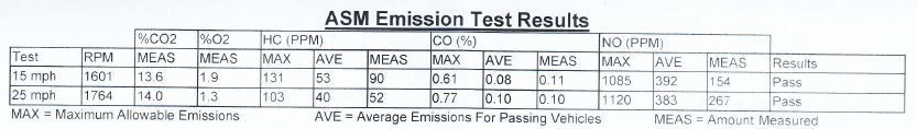

For reference, here are the latest numbers I see for my '87 22RE EFI with about 200k miles:

I'm with Jimkola on this. Have your tank filled with mostly fresh gas the day before (or nearly) the test, and splurge on the fancy fuel. Having the tank nearly full will help on the evap test -- ask me how I know.
But the biggest thing, find a smog shop who's old-vehicle-friendly, and willing to take the time to help it pass.
