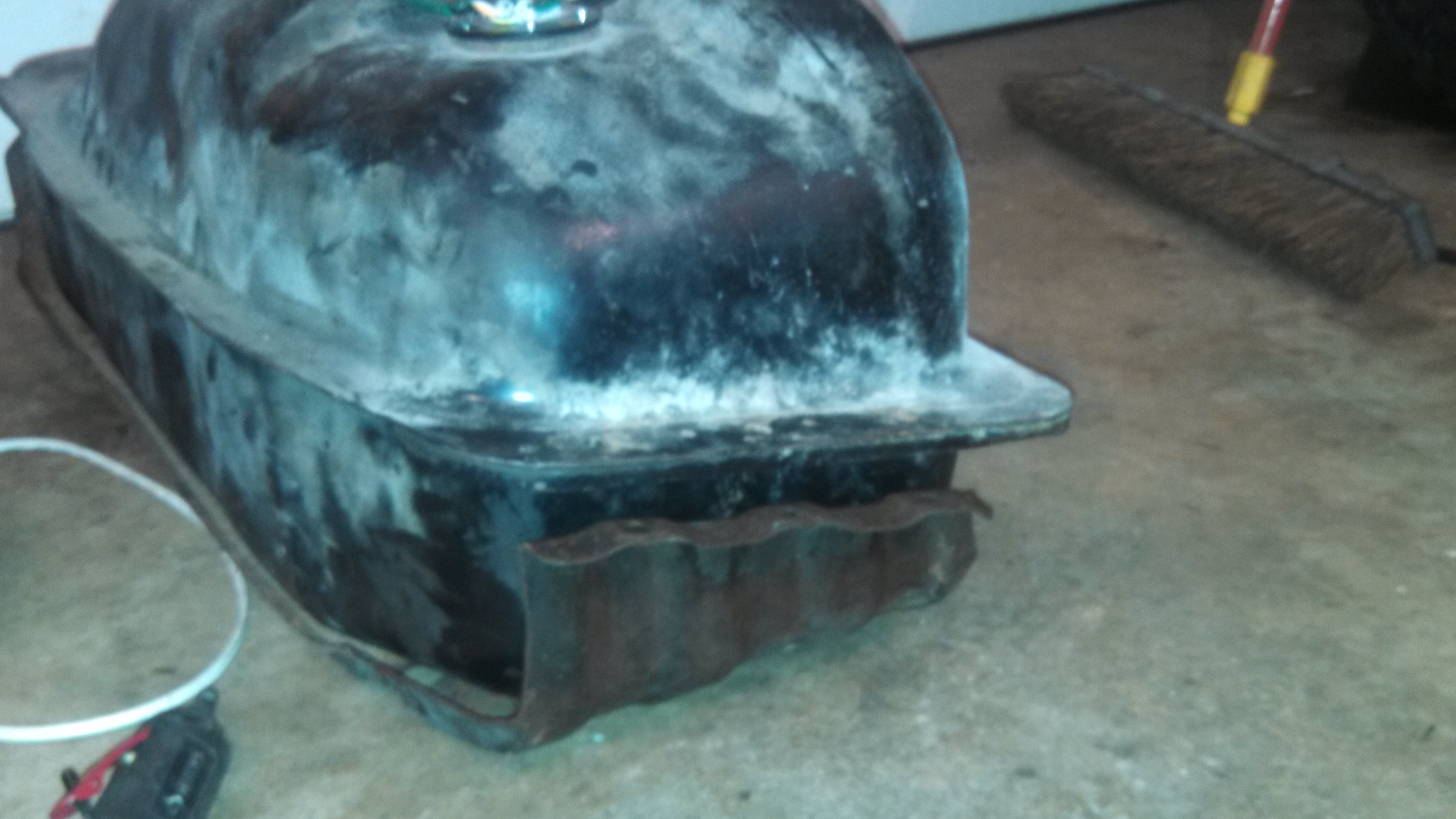

my 87' 4runner came with the fuel tank skid plate in the trunk. the previous owner had taken it off to do some (unknown) work on the fuel tank. i dropped the tank yesterday to replace the fuel gauge sending unit and figured now would be a good time to put the skid plate back on.
it fits fine on the front of the truck (i.e. facing the front of the truck) but there is a 2" gap at the rear of the tank and it appears that if there were no gap the bolt hole do not align.
any ideas?? is there a filler plate that's missing? can anyone look at there skid plate/rear fuel tank mounting points and take a picture?

Here's a pic
Attached is a pic.

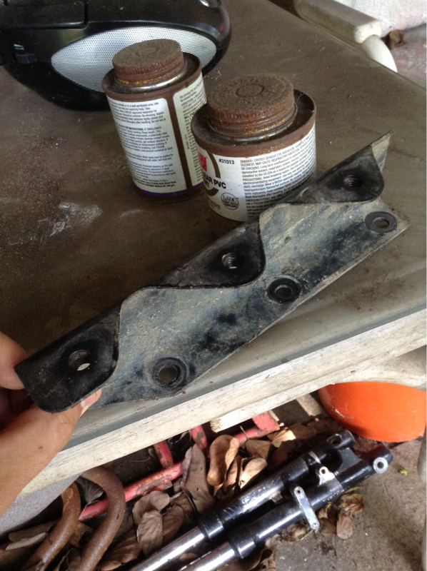

This is the piece that is missing
Not sure what it's called but it fills that gap

thank you! that answers a lot of questions.
This truck came with a pile of crap in the trunk. i'll look for something that looks like that.
