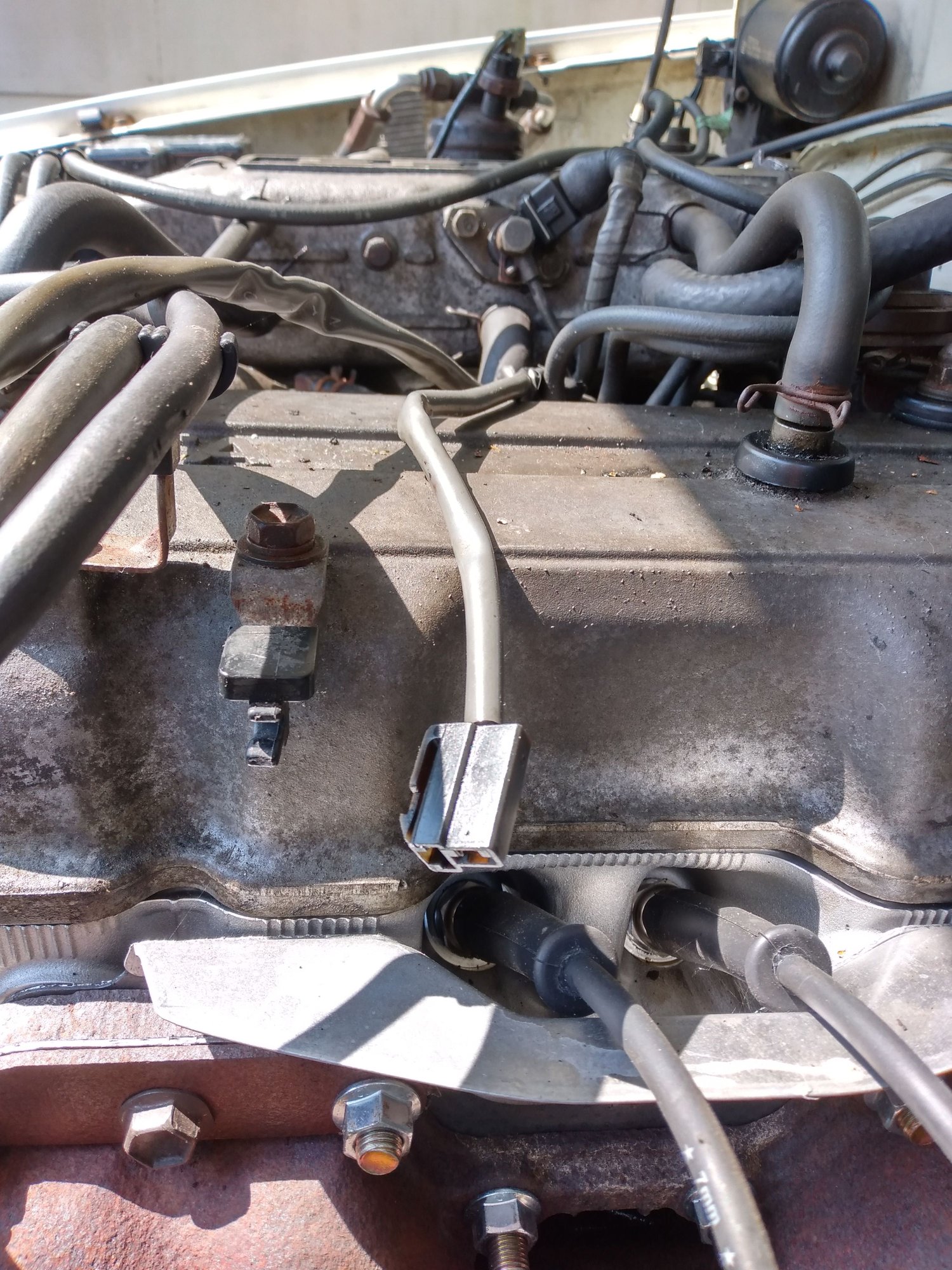

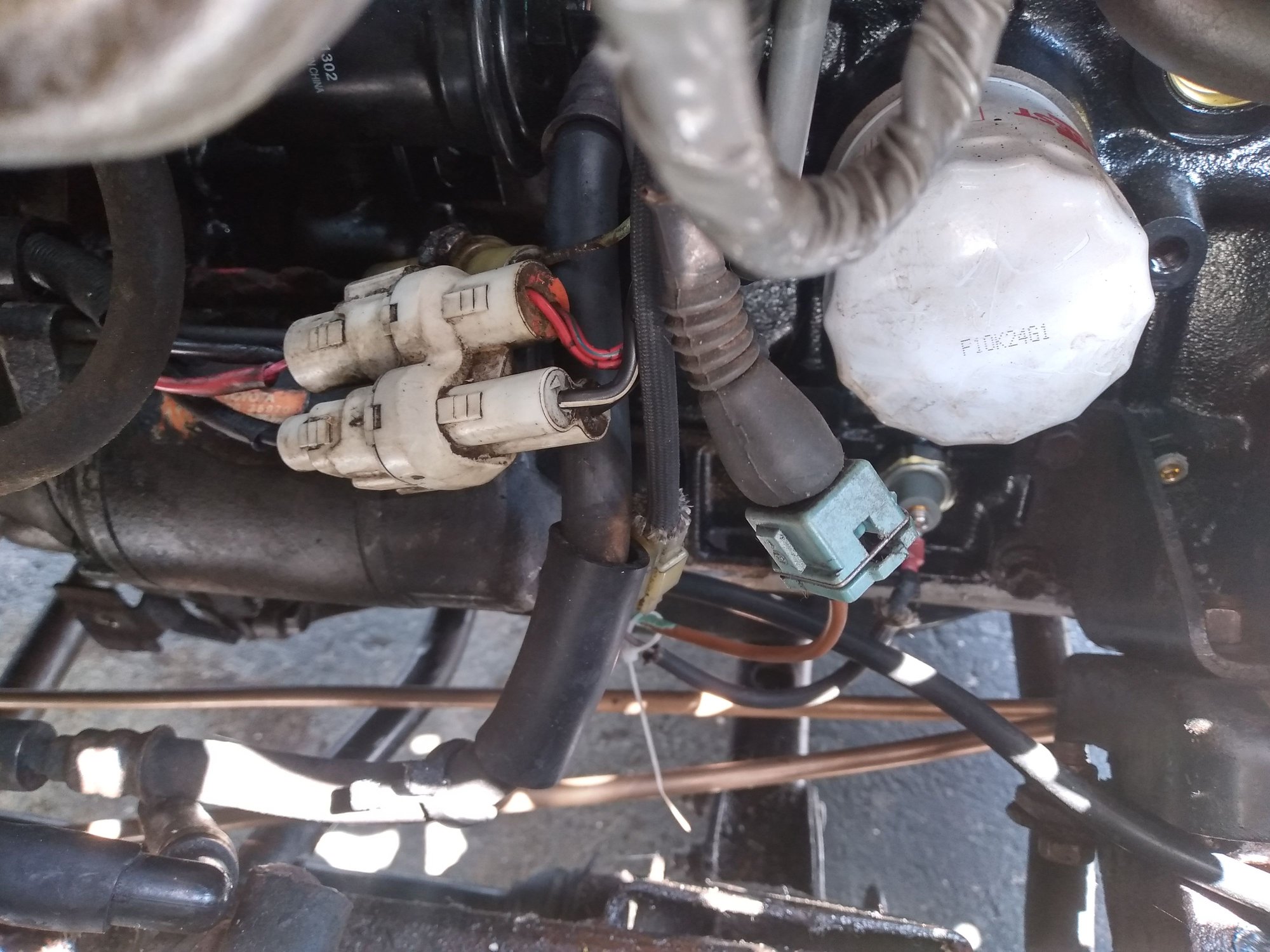

did my first engine swap at 68 yrs old, replaced blown 1987 22re with a new long block.all went well, started right up but I have 2 wires in the harness I can't figure where they go. See pix, the greenish connector is really light blue. thanks for your help

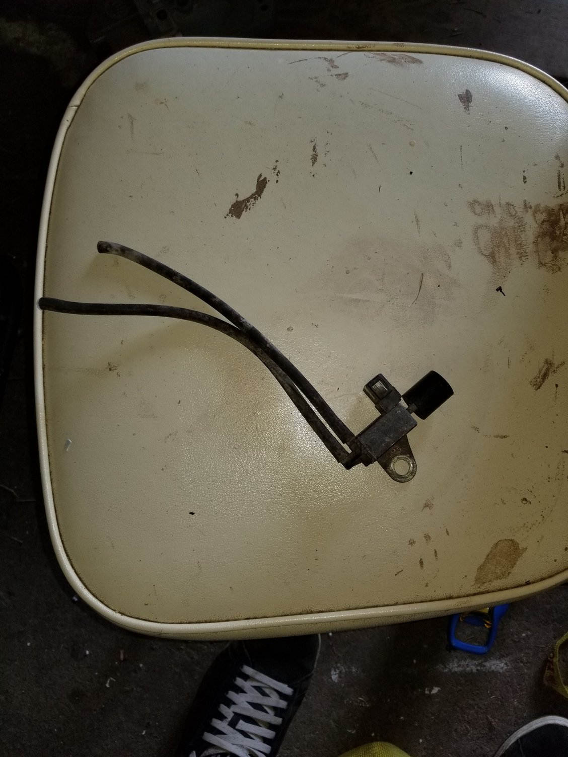

I think the one in your second picture is the connection that goes to the A/C idle up VSV, as shown below. The vac lines are supposed to connect to the idle up valve that mounts to the side of the intake, which you don't have.

First one is the iacv, below and behind throttle body
Second is the AC idle up, it always has this distinctive bend where it was folded up at the factory.
