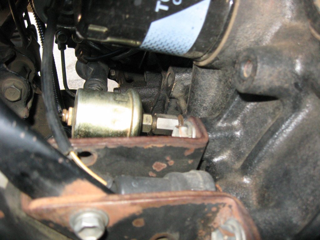

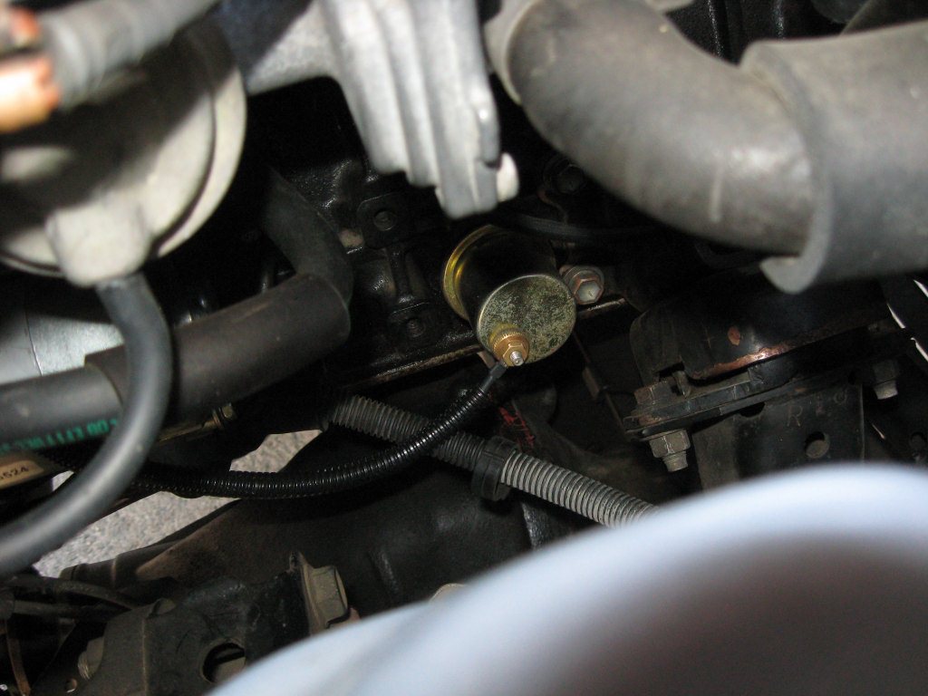

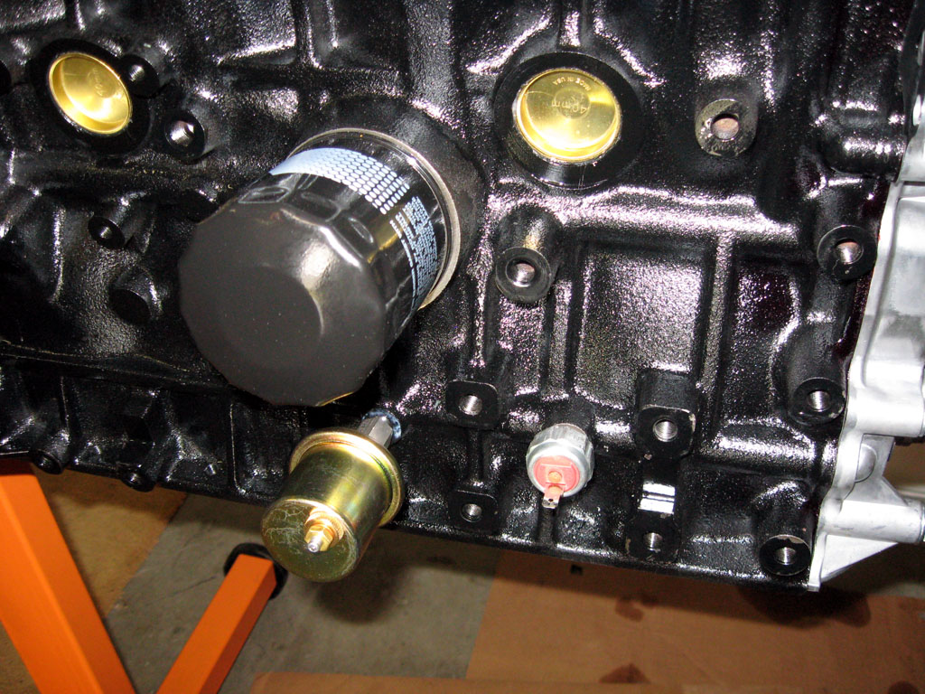

I use both ports, I put the small idiot light sending unit in the port that rests inside the engine mount, it fits just fine in there.

They are both oil plugs and travel through the same oil passage and both the same thread as the oil pressure switch so all you need to do is buy a mechanical universal oil pressure gauge from you favorite auto parts store and run straight into either of the two ports. You could even installed a 90 degree elbow so the clear oil pressure line won't kink on you if our prefer.
