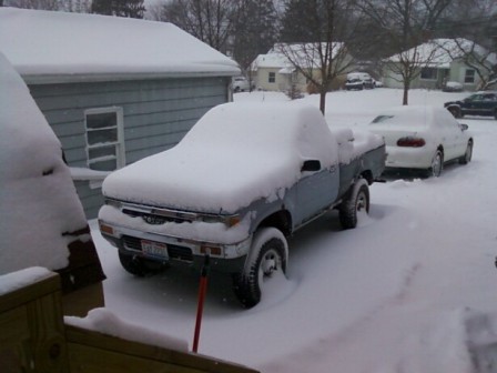

Ill check out those places and see about saving some $. THanks once again everyone!!
Id love to be out there working on it now but dont feel like climbing around in this and 15 degrees......
