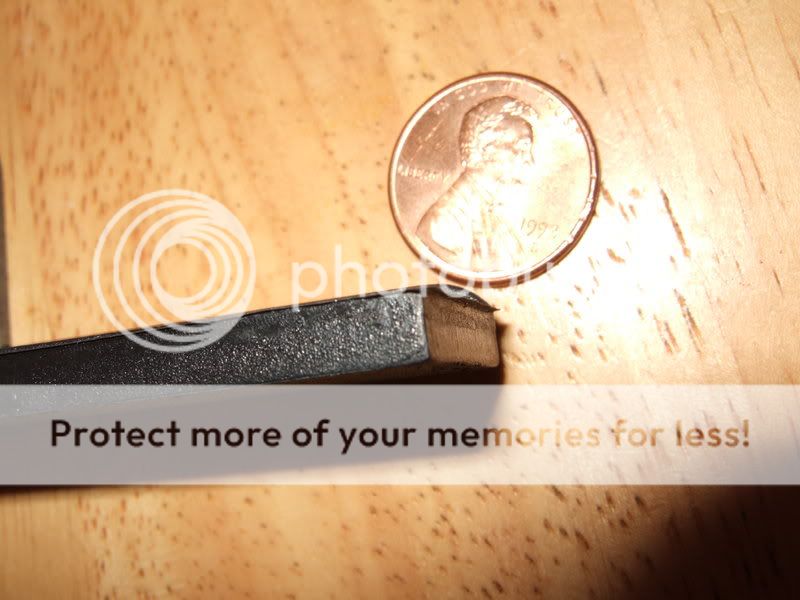

Here's what is in the timing box from my master rebuild kit.

so, what part of the driver's side guide is steel? it's hard to tell from this pic. It looks to me like where the two bolt holes are is steel but the guide is plastic?

the mounting holes are bare steel, and the guide portion is steel as well, but there's a sort of rubberized coating on it

Somewhere around half of the thickness of the driver's side guide is rubber/plastic. I thought it would have more and be made of a harder material. I haven't seen any other metal-backed guides up close, so perhaps this is the norm. Personally, I'd feel more comfortable with thicker, denser material on top.
The passenger side guide is all plastic.
Driver's guide:
