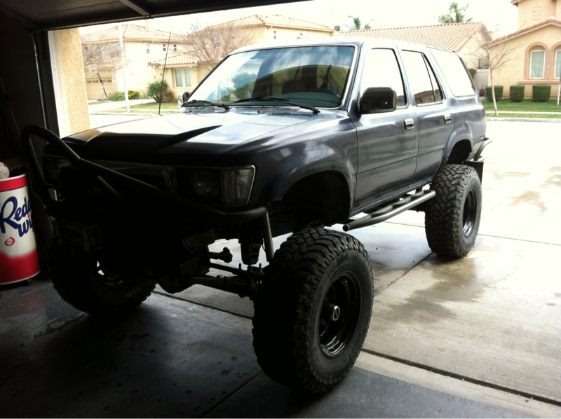

My sons 1990 3.0 V6 4Runner has issues when it's first started in the morning. It takes about ten to fifteen minutes to get it running smoothly. It's five speed and if you give it to much throttle it wants to die. Once it's warmed up though it runs like a champ. Any remedies for this? So far I've changed the fuel filter, it has a clean K&N filter in it. It passed a smog check with flying colors, fresh Mobil 1 oil and filter change. The plug wires are new but I have not checked the plugs yet. Could the plugs have anything to do with the warm up issues? I don't really know what else to check.
