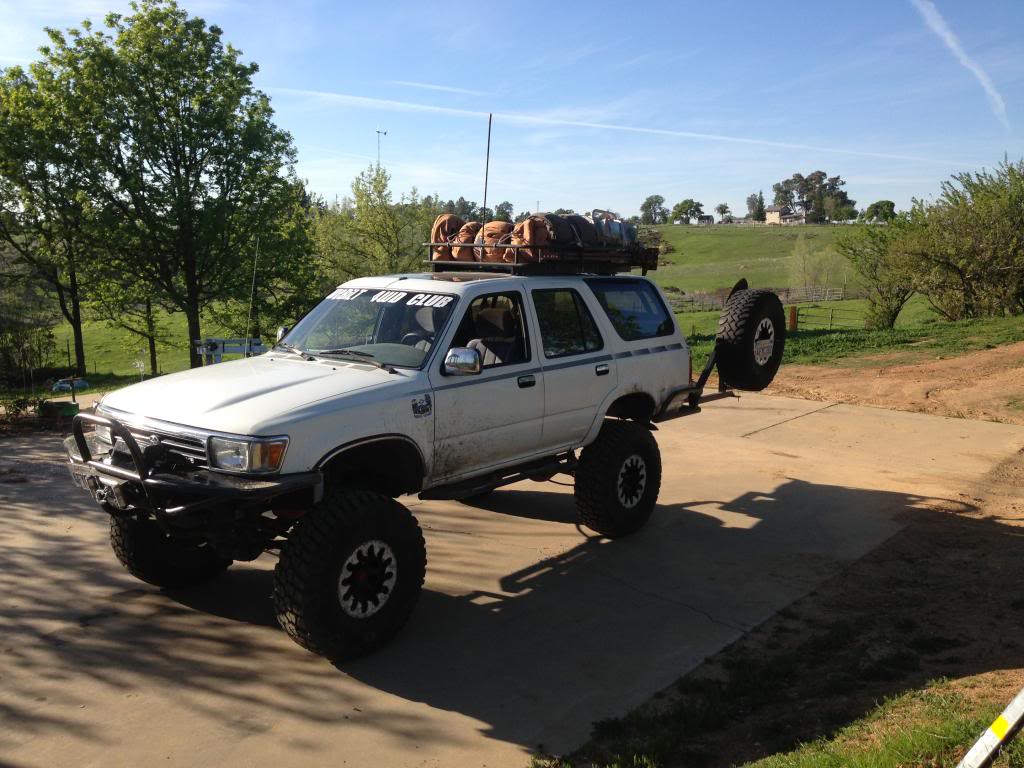

Heres mine. 1994 gm 4.3 , l460e
It will cost more, take longer than you think to do a swap.
For me the pro's. Super easy to work on , parts are every where , parts are cheap, 195 hp stock. Great power and drivability . Fits like a stock motor. Cal smog legal.
The con's. Bad gas milage 13mpg average around town 16 mpg freeway. Which is about what my 3.0 was getting.
Would i do again , hell yes. My 4runner is a 92 obd1 smog . I wanted to stay obd1 because its a little easer to pass. If i was to do again i would think about the toy 3.4 a little more, swap is easer . Also i wanted an auto and the gm 4.3 works very well with an auto. I don't think i would ever want to wheel/drive stick again.
