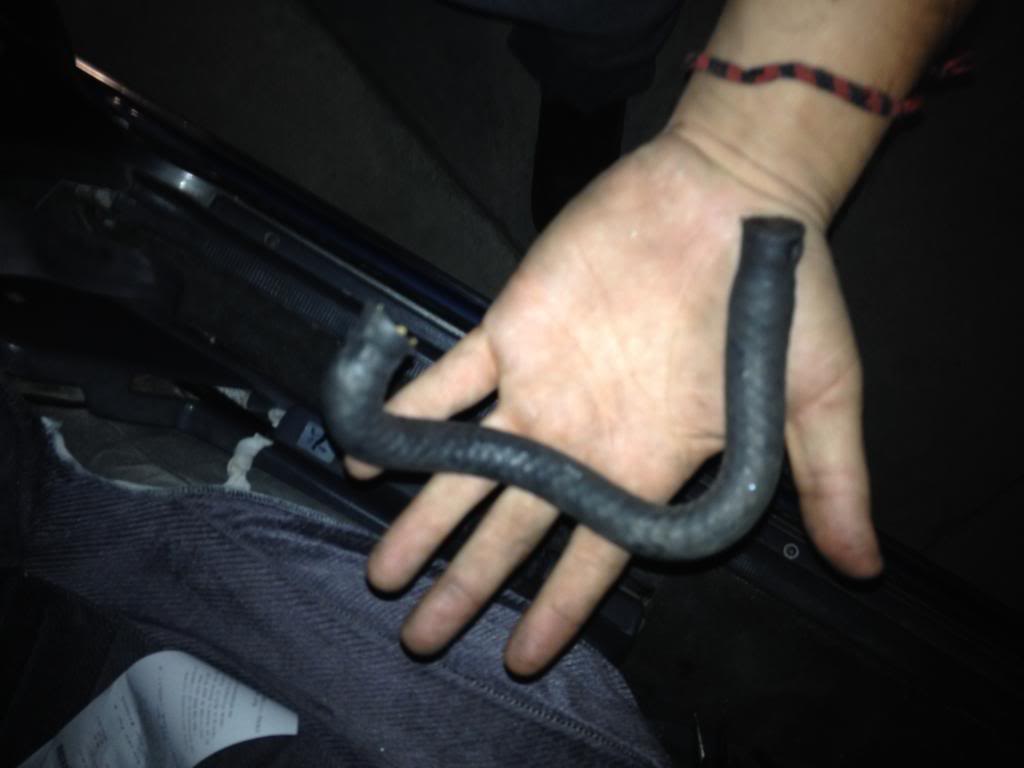

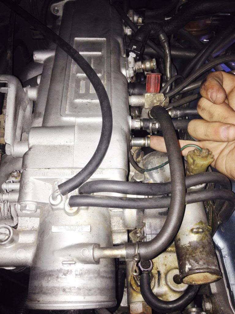

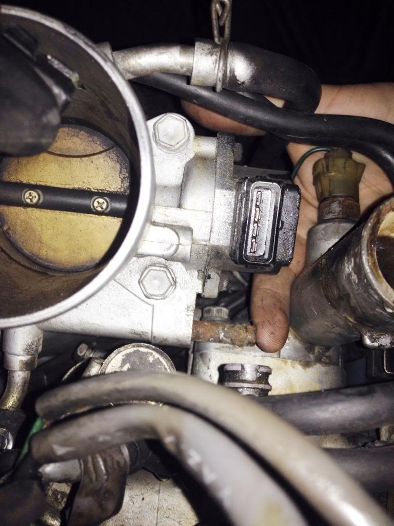

I'm not sure what this hose it called. Been going to some of the local autoparts stores and they don't seem to have it. The hose is part of the EFI and I think it's a bypass hose. Does anyone know the proper name?
The hose goes to nipples my fingers are covering up.

And yes I know it's very dirty.
This is the hose below:

Your only going to find that at the dealer or just run a piece of 5/16" long enough that it does not crimp.

From: Cheyenne, Wyoming
Water by pass #2
16264-35012
85-88 22re
