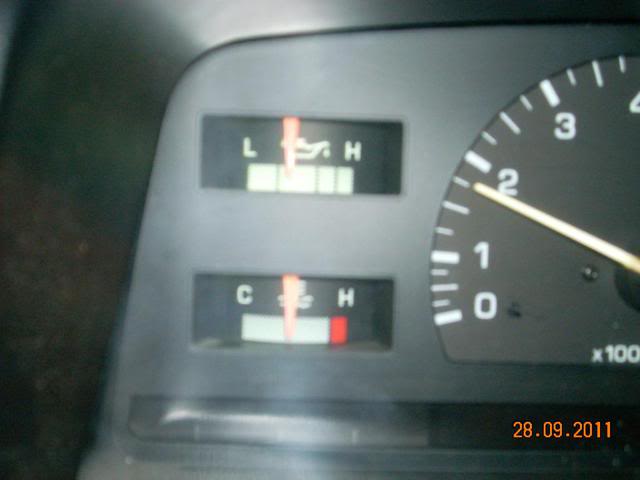

1st pic of left side oil and water temp when engine warm.

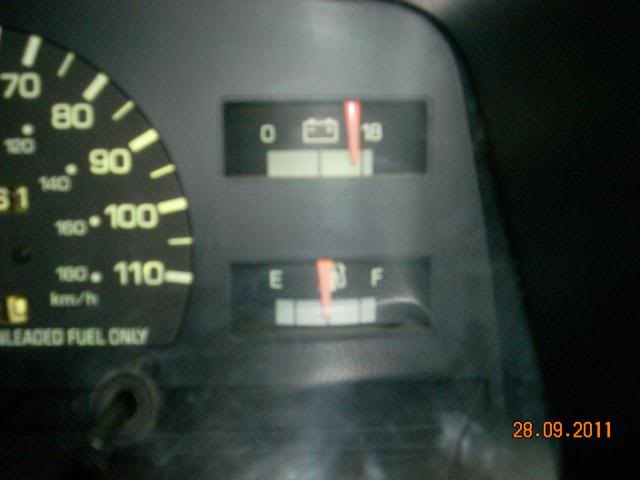

2nd pic of right side battery and fuel.

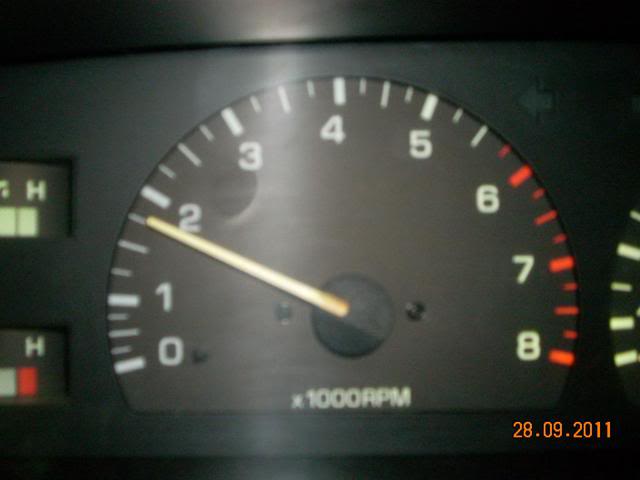

3rd pic of tach where it sat at 1750 RPM's and wouldn't go down, after timing was adjusted and jumper removed.
