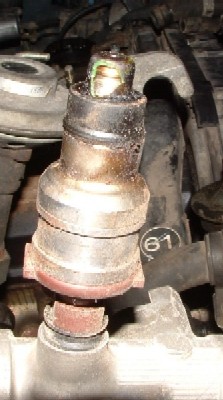

I pulled the truck apart tonight...
MAN is it a mess under there.
The upper and lower intake are filled with gunga.
the plastic tips of some of the injectors is chipped and/or broken.
And there are little bits of plastic in the valleys below the injector rails.
:confused:

Holy Crap! Man, I thought MY engine bay looked dirty!
Bumpin'Yota has a thread going now with lots of details on his teardown, including great pics. I'd suggest you search on his ID and find it for some good tips...
