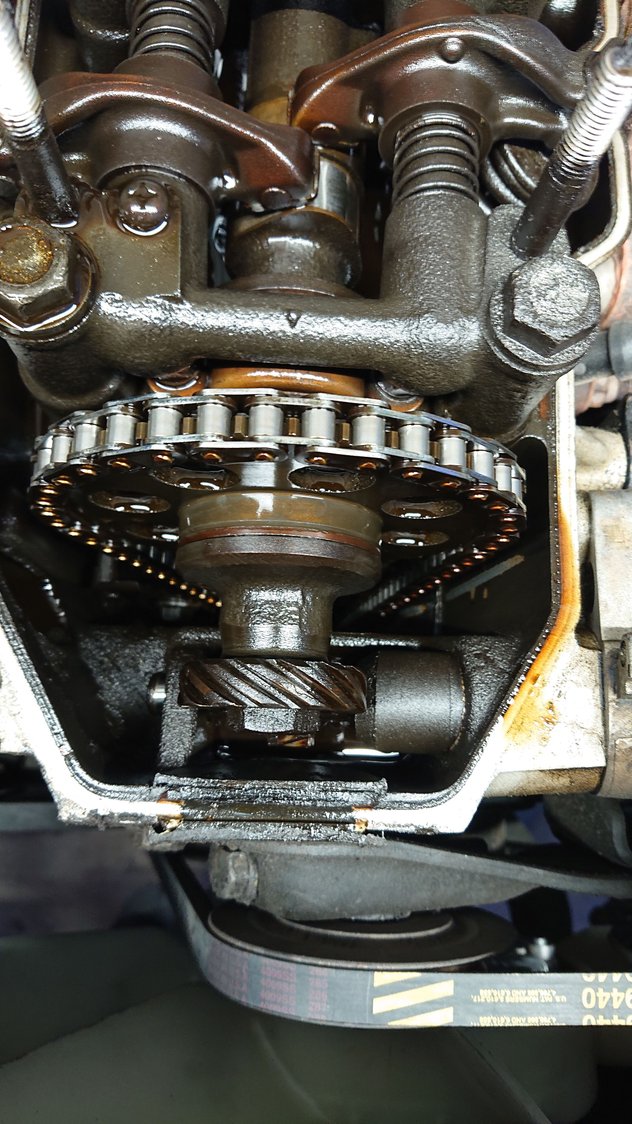

I can’t tell much from the video but it is typically the driver’s side chain guide that breaks and then the chain slaps. You can see it when you remove the valve cover. How many miles on this engine?

You nailed it Melrose. I pulled the cover and the driver's side chain guide is mostly gone. The chain has already gouged almost 1mm into the cover too so I'm going to find a lot of plastic and metal in my oil pan. The engine has 340k on it and the previous owner rebuilt it around 120k ago. The rockers and cam are in amazing condition though, barely a scratch on them.

I did a timing chain/oil pump/water pump replacement 6 years ago on my '93 Yota 4x4 and encountered the same noise as yours. The driver's side chain guide has the chain tensioned so it's always rubbing it but loose on the passenger's side. The driver's side guide broke so I had to drop the oil pan to get the pieces out. Since I have a 4x4, I had to drop the front diff and the driveshaft to slide the pan back.
