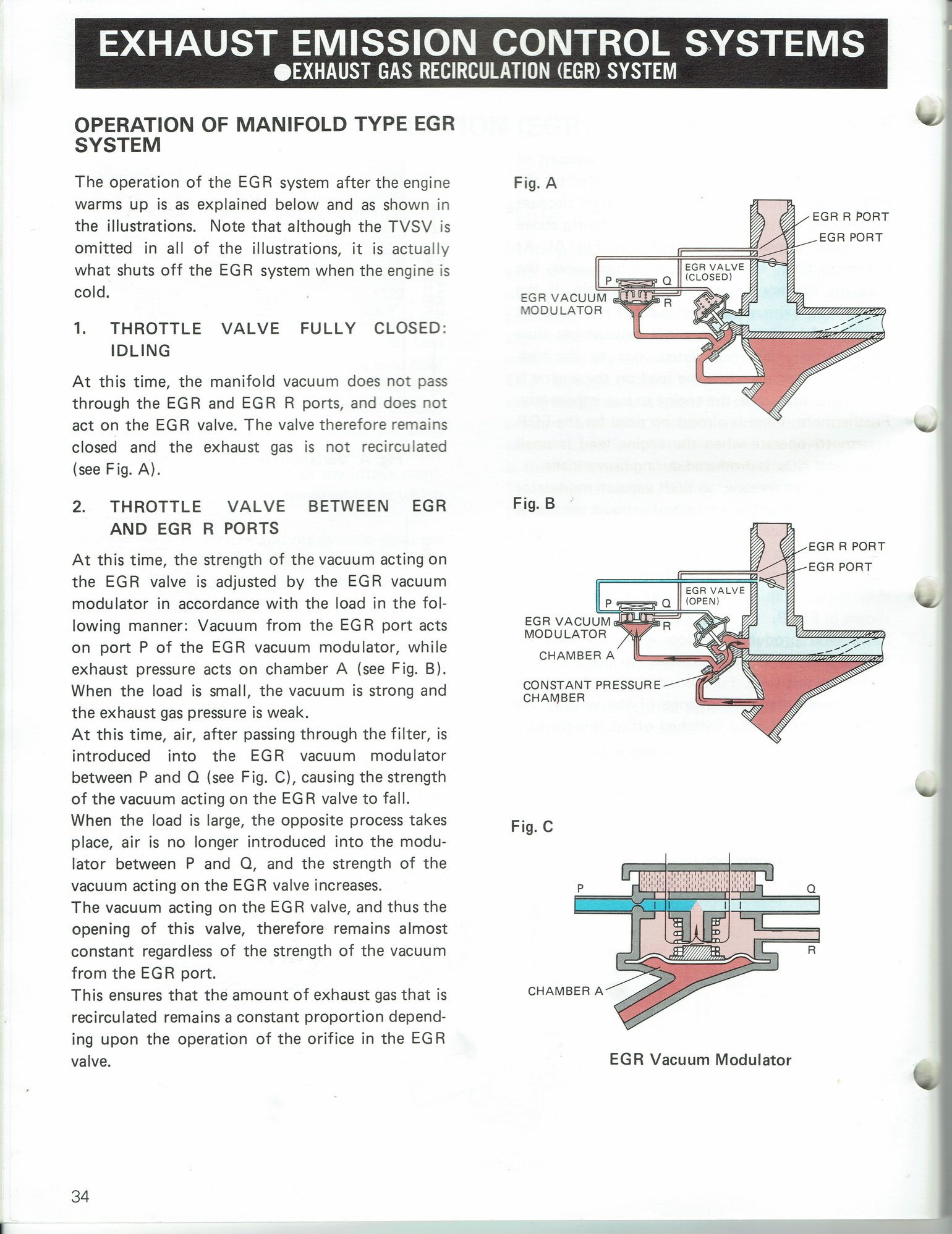

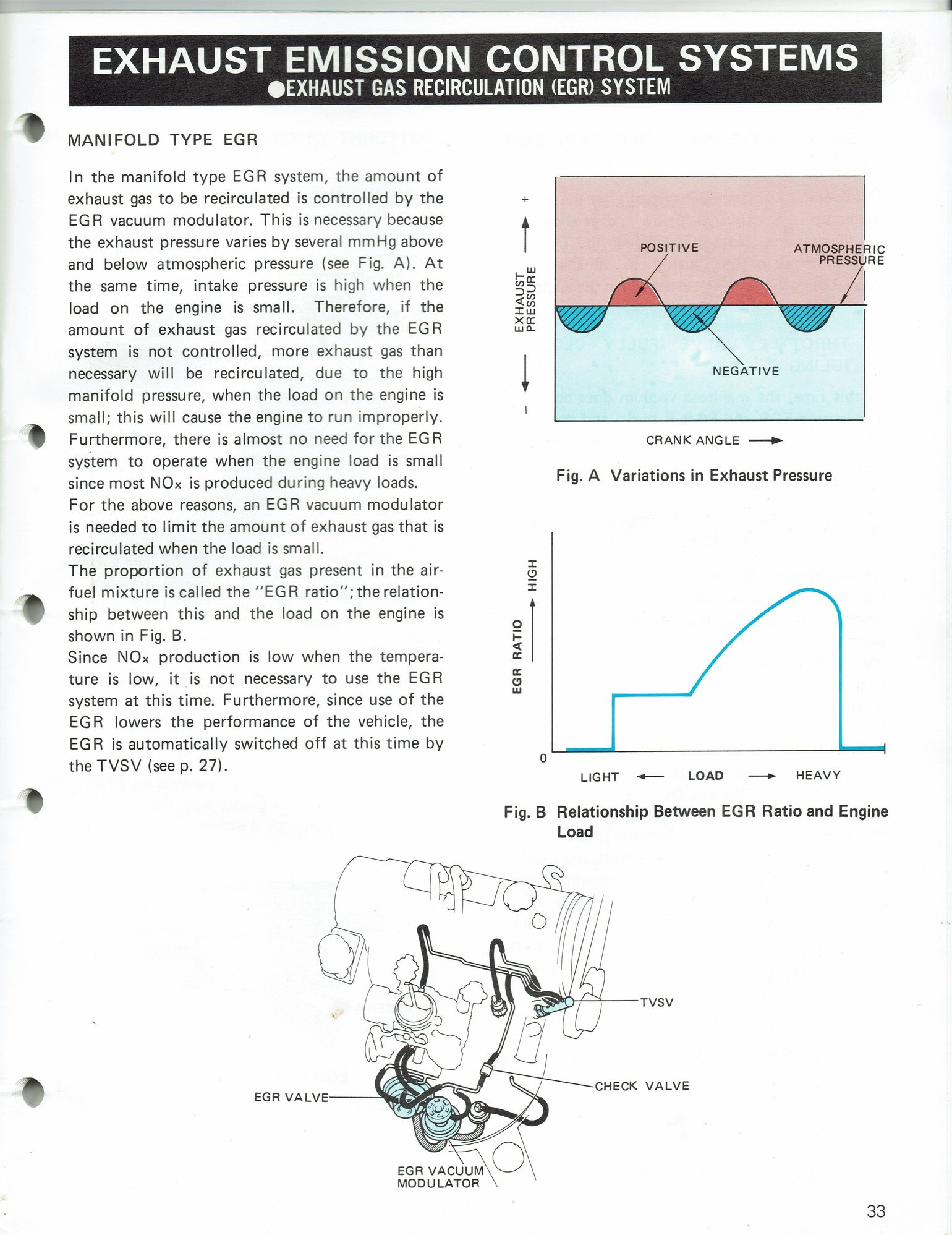

Here's some info from a Toyota Emissions training class manual back in the 1980's. sorry for the large size. In a hurry to make a movie
