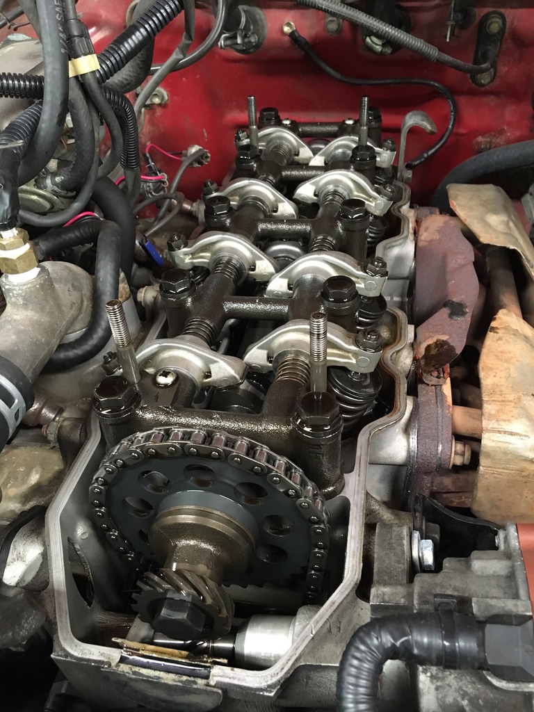

Adjusted the valves this afternoon -- just needed a tweak here and there, nothing odd.
