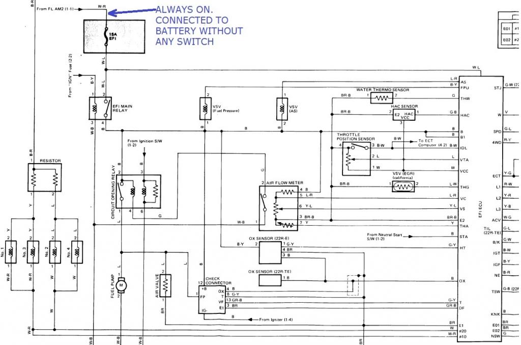

Im no wiring expert, if you were going to wire an inline switch to disable the EFI fuse/relay where would you do it? I have attached a wiring diagram with 4 possible locations that I can see, are any of these better than the other?
Which one would be the lowest amp rating that would not require a hefty switch to effectively disable? I was hoping to use a 16 amp switch i have on location 3, but have no idea if that is a good spot to do it..
The "From "IGN" Fuse (2-2)" is run off a 7.5 amp fuse, which seems to be actuated when the key is in the on position ( i think).

Position 3 involves the least current; just the draw of the relay coil, which is probably much less than 0.5 amps.
You are correct about the 7.5a IGN fuse; it is downstream of the ignition switch.

Can you think of any I'll effects caused by interrupting the efi relay at position 3? I hope the ecu would have no lasting impact if it were attempted to be started with that relay inoperable.. Any codes or damage possible?
Concur.
Final answer: point 3
No ill effect. That's the proper place for one of the many kill switches you can install.

The wire between your marks 1 and 2 (a Black-Green wire, if you care) provides "always on" power to the ECM. If you opened the circuit at 1 (or took out the EFI fuse), the ECM would lose power, and I expect it would lose fuel trim from one time to the next.
As you might know, the injectors have 12v always to one side, and they are opened by the ECM grounding the terminals labelled #10 and #20. The 12v side of the injector is powered from the ignition switch. SO, if you turned the ignition switch on but kept the EFI relay from closing (so no power to the ECM), do terminals #10 and #20 go to ground (which would open the injectors) or "open circuit"? I expect the latter, as that would be the safest way to design the circuit, but I don't know the answer.

Rad, thanks very much for the confirmation on this. I will move ahead and try this out, will be nice to have some more hoops for those thieves to get through.
Scope, sorry I don't fully understand, are you suggesting interrupting the signal to the injectors as another type of kill switch? I had thought about this but wasn't sure how delicate the signaling to the injectors were and thought there could possibly be some degradation of the injector pulses if i added a switch in there. Probably over thinking it tho.

I'm saying don't use position #1; you'll lose fuel trim data.
I don't know if cutting power to the EFI relay (which removes main power from the ECU) leaves the injectors closed or open, but I'm almost certainly it would leave the them closed (meaning: #10 and #20 would be "open circuit" with no power to the ECU). Otherwise, turning on the ignition switch with no power to the EFI relay would cause the injectors to spray fuel (from residual pressure; the pump won't start) into the cylinders.
I don't know the answer for sure, but I'm pretty sure that WON'T happen and your plan is fine.

I dug around in my kick panel and found the correct wire to interrupt, confirmed with my multi-meter. Looking good, thanks again guys for your help!
Concur. "W-L" wire into EFI ECU needs to stay on. This must be the one that preserves ECU data. Cutting point 1 will remove power to ECU.
I believe that's correct, too. ECU needs to power up from pins B & B1 coming from EFI main relay. With that off, ECU will not be able to ground pins #10 & #20.

Bonus idea...
kill switch to interrupt green wire between C.O.R. and AFM contacts would also be a nice, low-power and puzzling kill area Truck will have combustion, but only when ignition is in start position.
