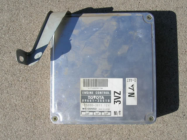

I actually have a '90 5spd ECM for sale. I can't give you a definitive answer on compatibly though.

thanks but I just noticed your pin configuration is different than mine. Mine is 10-18-24...Thanks Rob
Interesting that they'd be so different. Your ECM is missing a heck of a lot of pins for just one year different. Wonder what Toyota added between years?
