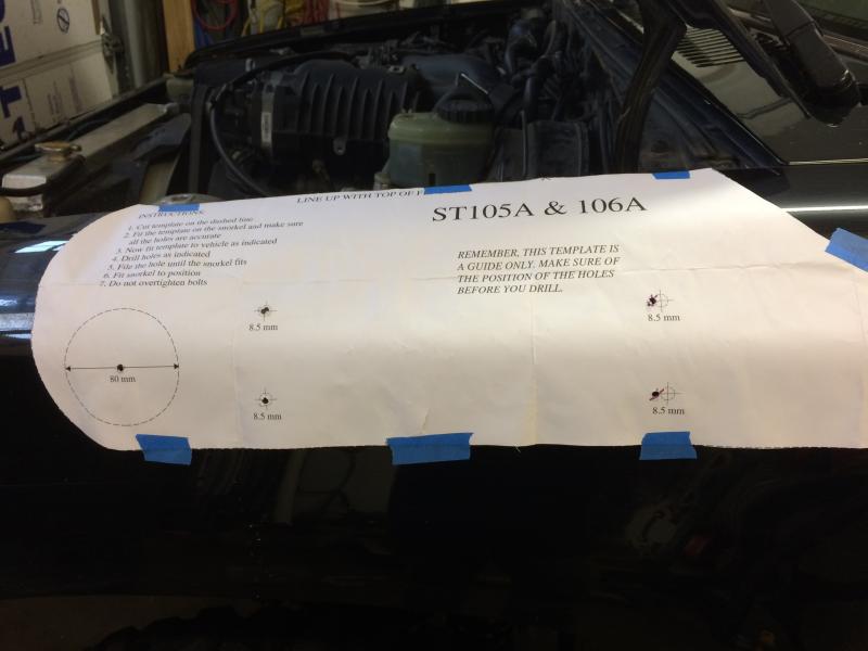

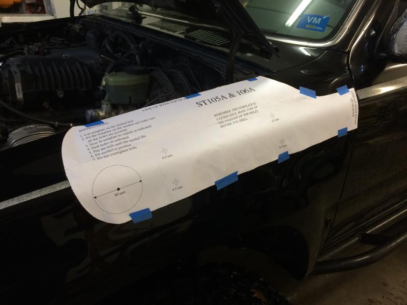

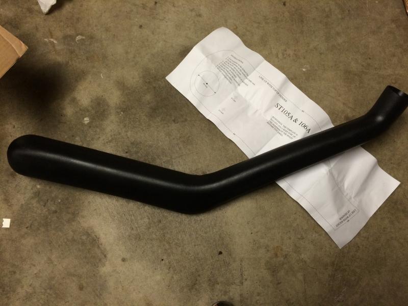

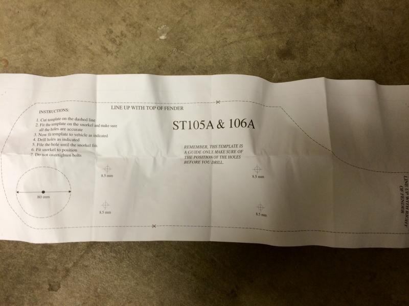

Here are a few shots. The kit did include a template, you cut it out on the dotted line and then match to your fender. Not sure how accurate it is yet, I need to check that out still.

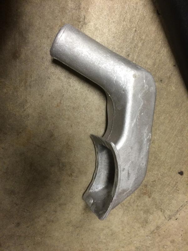

This is the piece that connects to the stock airbox. I have a 3.4 and we never moved the battery to the drivers side like most do. So my plan is to run an intake tube from the drivers side to the passenger to connect.

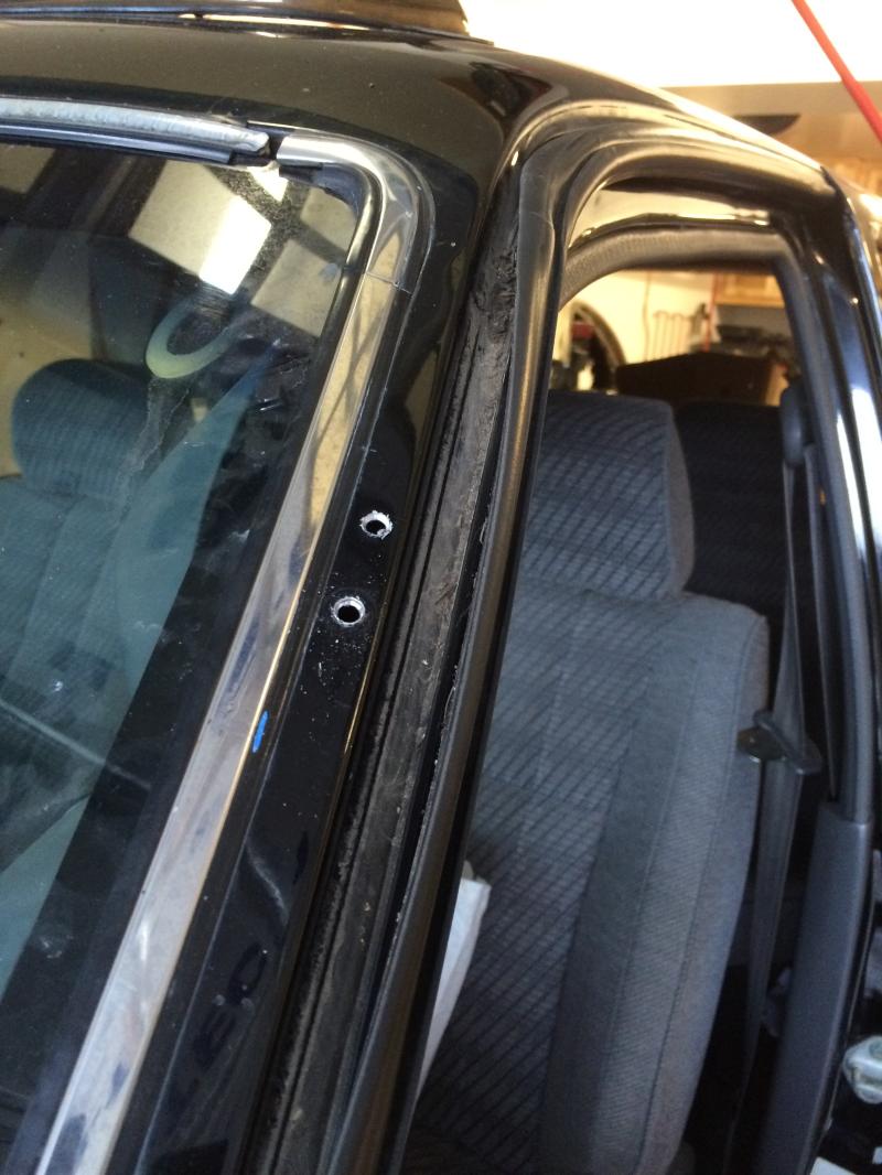

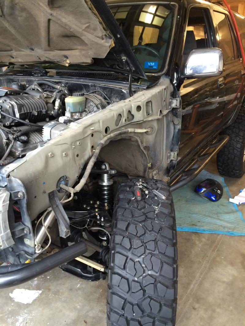

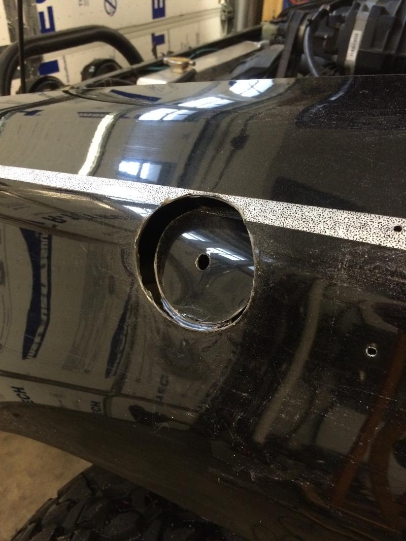

Well I finally got around to getting this installed. Yesterday I headed up to my friends place because I was more comfortable with him hacking into my fender than I was.

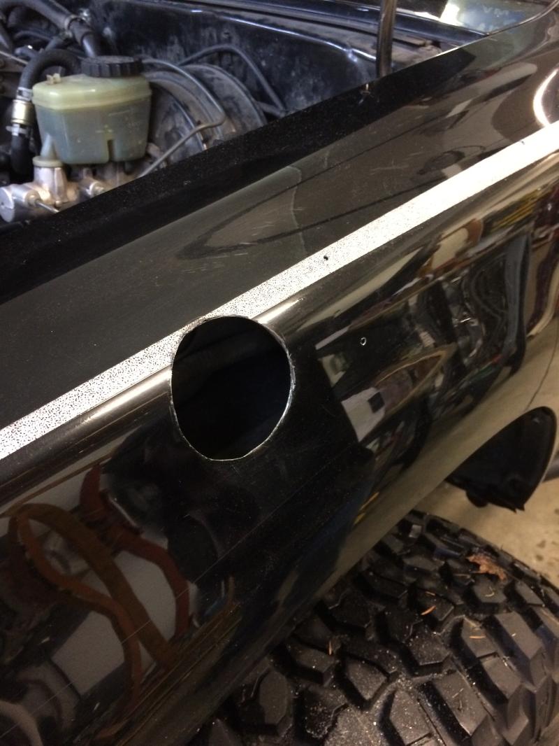

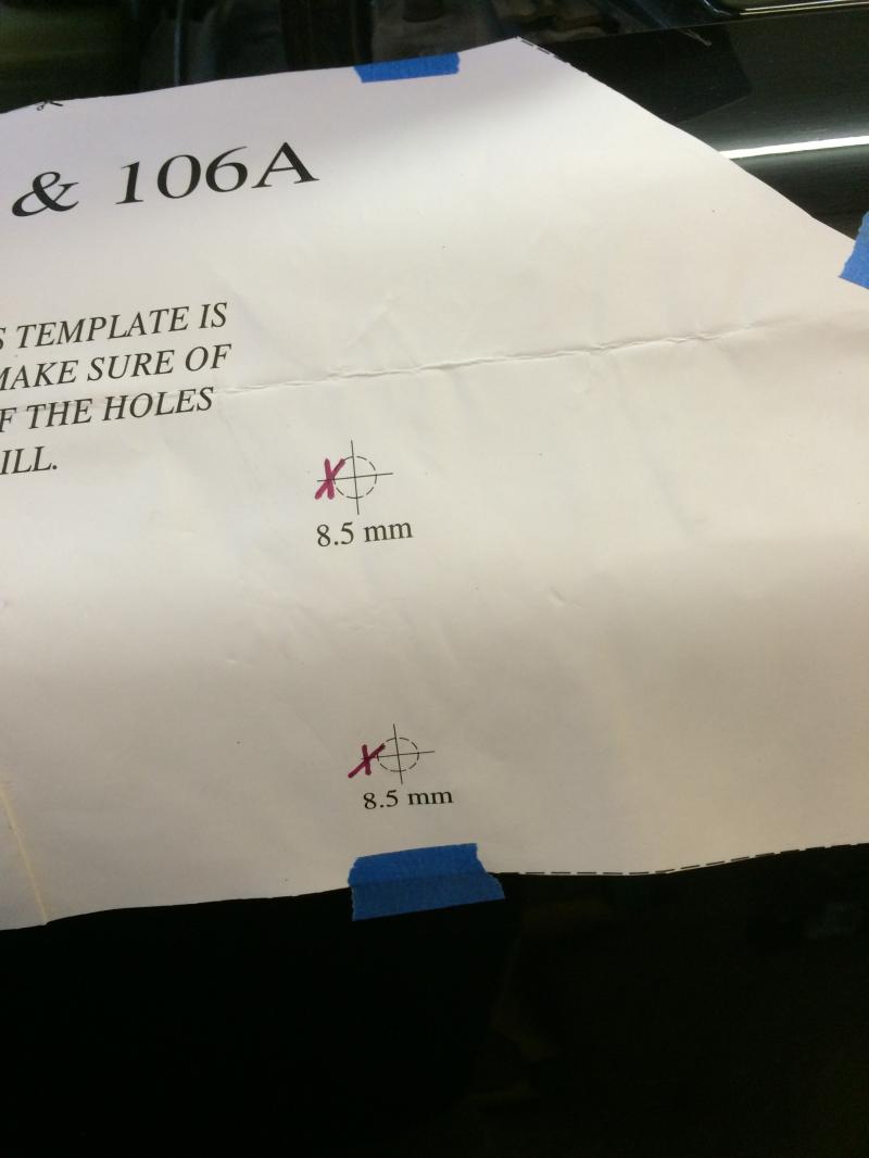

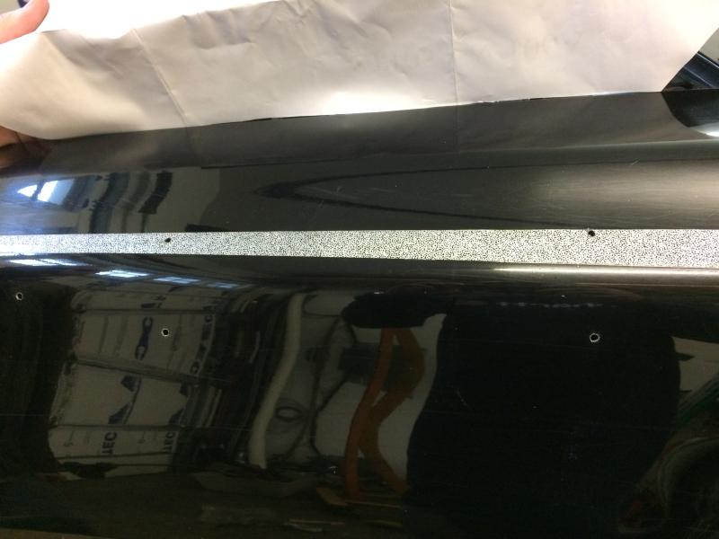

First of all the template was close, but not perfect. The holes closest to the door were not correct, luckily we checked before drilling. Even after the initial holes were drilled there was some hogging out to make things work. All covered by the snorkel.
Here's some pics of the install. I do not have it hooked up to my intake yet since I have the 3.4 and we are going to have to get creative.

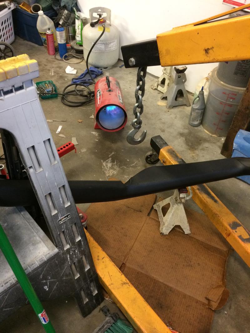

Once we got the big hole drilled, it seemed like there was a gap at the top horizontal part where it met the fender. We decided to heat it up slightly to see if we could make it better. Not sure this was necessary because it always returned to shape. Right now it sits perfect against the fender.
My buddy hogging out the hole a little to make it all fit. The hole is suppose to be 80mm, which is slightly over 3". We had a 3" hole saw so this is what we did.
There are no instructions included with the kit. WTF. Near as we could tell with the hardware included, they wanted us to rivet the upper bracket to the a-pillar. I wasn't crazy about that so we came up with the idea of putting in nut-certs. Turned out incredible and now the snorkel is removable if needed.
